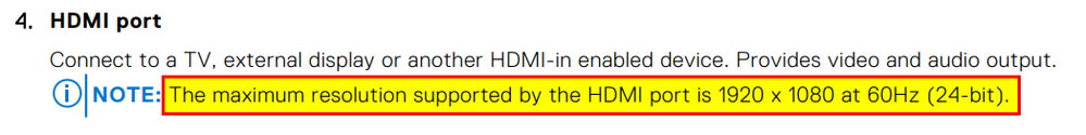

Hey there, finally someone addressed this issue . i am also facing this issue . I am also not able to use my monitor at 120hz from my intel iris xe and i5-1135G7 . The last refresh rate i can change in settings is 60hz interlaced. Infact the lower cpu like i3 are able to run 120hz at 1080 . There is no monitor issue and cable issue

ABHINAV2454
2,534 Views
No bro , I have Dell Insipirion 3501 with monitor ViewSonic VX2779-HD-PRO(180Hz)
MUC
Honored Contributor I
2,515 Views
I know it's hard to understand, but the capabilities of an HDMI port are not dominated by the graphics card but by the other technology that an Original Equipment Manufacturer (OEM) like Dell uses on the way from the processor to the port.
Inspiron 3501 Setup and Specifications
Since this laptop has no other video output, you will have to live with this limitation or return the device (if that is still possible).
