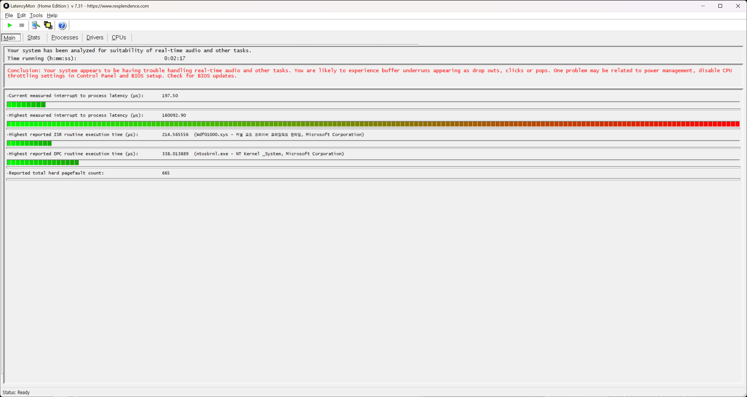

Hi I found a compatibility issue between A770 and audio card.
I tested on Samsung EE-UC10J(usb-c to 3.5mm) and onboard sound(ALC897) and found the same issue.
Stutter occurs regardless of time. It is very sad when stutter occurs during competitive games.
The easiest way to reproduce the error is to open Task Manager after 3 minutes of video or audio playback.
The error is always the same, but sometimes LatencyMon detects the error and sometimes it does not. The attached image is the message when the error is detected.
https://www.youtube.com/watch?v=7Gi3qW2-z4o
The linked video did not detect the error in LatencyMon. but, it is a perfect video to explain the error.
I checked similar inquiries, but it is not a ReBAR issue. Driver fix is ​​needed.
The only solution I've found is to always keep task manager open to avoid the stutter.

Hi I am happy to report that I finally solved this issue. The cause is power options.
Set power options to hard disk-turn off hard disk after-1 minute, there is an issue I reported.
If you disable this (it changes to 0 when apply it), the stutter does not occur.
I also had the same issue with my 11th generation GPU, UHD750, so I wonder if it is a universal issue with Intel GPUs.
Actually, I did not have the issue with other manufacturers' GPUs.
I would like to use the hard disk power saving feature to save the planet.
Can you confirm and reproduce the issue in your lab?
And if you use Settings > System > Power & battery - power mode in Windows 11, it cannot manipulate this setting, so it needs to be modified.

hi
1. external speaker
2. displayport 1.4
3. the problem also occurs when using a jack adapter and the built-in audio card
4. I changed Primary Graphics Adapter to Onboard in BIOS and used the integrated graphics.
5.
After entering Windows, set the power option to hard disk-turn off hard disk after-1 minute.
High performance, standard, and power saving are not important.
You will probably need another disk (for example, D drive) because the drive needs to go sleep.
It doesn't matter whether it's an SSD or an HDD. (I don't use an HDD and I use two SSDs)
After that, wait for 2-3 minutes by watching a video, listening to music, or playing a game until D drive sleeps.
After that, do something that will wake up D drive. The most effective way was to open Task Manager.
The screen freezes for a moment and the sound stutters.
This is one way to force an error. The problem is that this error occurs frequently.
I think it may be a Windows error, but I ask for confirmation because it did not occur with dGPUs from other manufacturers.
