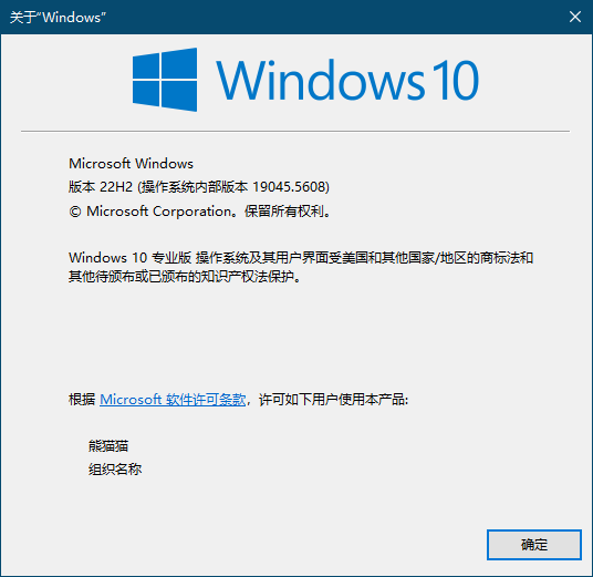

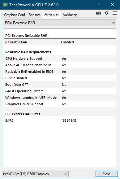

Hi Xiongmaomao,
Thank you for the update. Please confirm if you performed clean installation or DDU before installing the latest driver.
In line with this, is the resizable bar enabled? Is the Windows Operating System up to date?

Yes, before installing the latest driver, I entered safe mode and used DDU to delete everything. The installation was a completely new installation
resizable bar enable and Windows Operating System version ,I provided two screenshots that you can view
