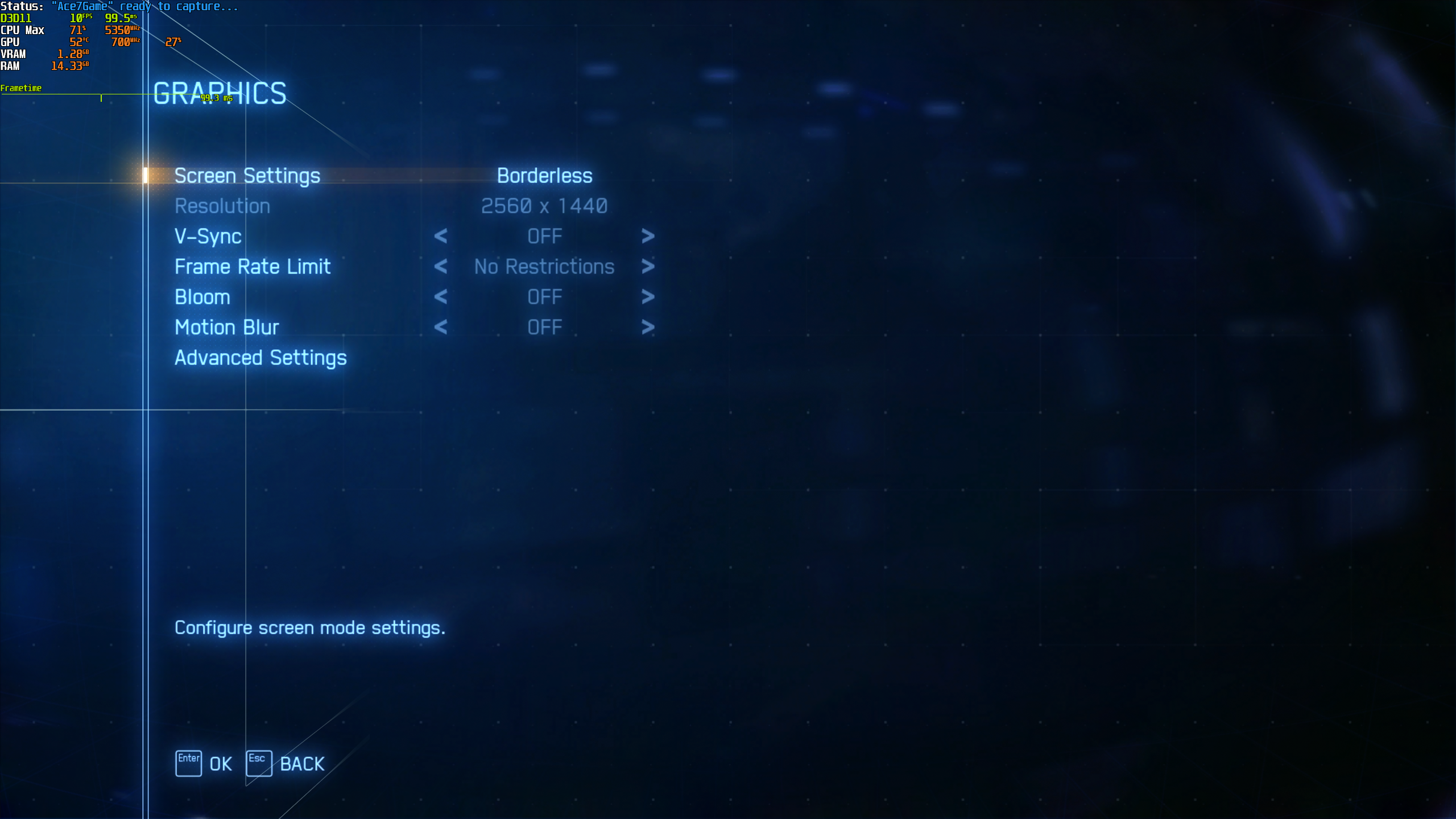

Card: Onix Odyssey Intel Arc B570
Intel Arc Graphics Driver Version: 32.0.101.6647
System specs:
CPU: Ryzen 5 9600x
GPU: Onix Odyssey Intel Arc B570
RAM: 32 GB DDR5 6000 MHz
850W PSU
ISSUE: Hello, I am having an issue with Ace Combat 7, Steam version, where it does not seem to be utilizing my B570 card. I am running the game at native 1440p, all graphical settings are on high with FXAA high.
From the moment the game starts, in the opening splash screens, I am getting 10 - 15 FPS maximum. My B570 hovers around 20% usage, frequency stays between ~400 MHz and 800 MHz, and power draw stays between 19 W and 35 W, although it's spiked up to 50 W once. Only 1 GB of VRAM is being used.
I will make it clear, I am not playing the game at this moment. I am just in the main menu. On my old XFX RX580, a card far less powerful than my B570, I could consistently run AC7 on these exact settings over 60 FPS with no frametime or frame issues.
I cannot directly add .json files for some reason, despite the pinned post telling me to do so, so I'll add the CapFrameX files as .txts, with three Cyberpunk 2077 ones to compare against (Medium settings, balanced XeSS 1.3.2).
I've ruled out that it's an Unreal Engine 4 issue, as the frame problem is not replicable in other UE4 games, such as Project Wingman or AMID EVIL. Any help would be greatly appreciated as AC7 is a game I spend a great deal of time playing.

Thank you for trying out the latest Graphics Driver update, but since the issue still persists, can you make another CapFrameX recording with longer duration? ideally 3-5mins.
By the way, can you confirm if whether the app and game are utilizing the graphics card by setting it to Arc Graphics?
- For guidance, you can check our article How To Set the Default GPU for Applications and Games.
Can you also capture a screenshot of the game settings you're using so we can accurately replicate the problem using your configuration.

Attached is the requested information, including the CapFrameX recording, my in-game graphics settings for AC7, and the default GPU for AC7.

Hi @x6568tank
I was able to reproduce this issue, it turns out this behavior only reproduces when pairing AMD integrated graphics with Intel Arc discrete.
When using Intel integrated graphics + Intel Arc discrete the game runs correctly on the Arc GPU.
I'm not in the dev team myself, but my current hypothesis is that the game code is written so when Intel Graphics is detected the game skips it and prioritizes the non-Intel option, essentially assuming it is a less powerful integrated graphics since Arc GPU did not exist at the time the game was launched.
Anyway, I'll report this to our driver debug team for further investigation and will update this thread as soon as possible.
