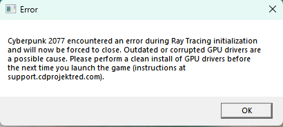

This is what I'm talking about and yes, I did clean install

Hello Lenthet3n,
Good day!
Please proceed with the following steps below:
1) Please contact your motherboard manufacturer support team to get help with the following:
- Update your BIOS firmware to the latest version, 3.40.
- Also, make sure that the Resizable Bar option is activated in BIOS. Please check and confirm if all requirements are met.
2) Once the BIOS firmware is updated and made sure all motherboard requirements are met, re-install the Intel® Graphics Driver 32.0.101.5762 using the Display Driver Uninstaller (DDU).
We'll give you time on this and will wait for your reply.
JeanetteC.
