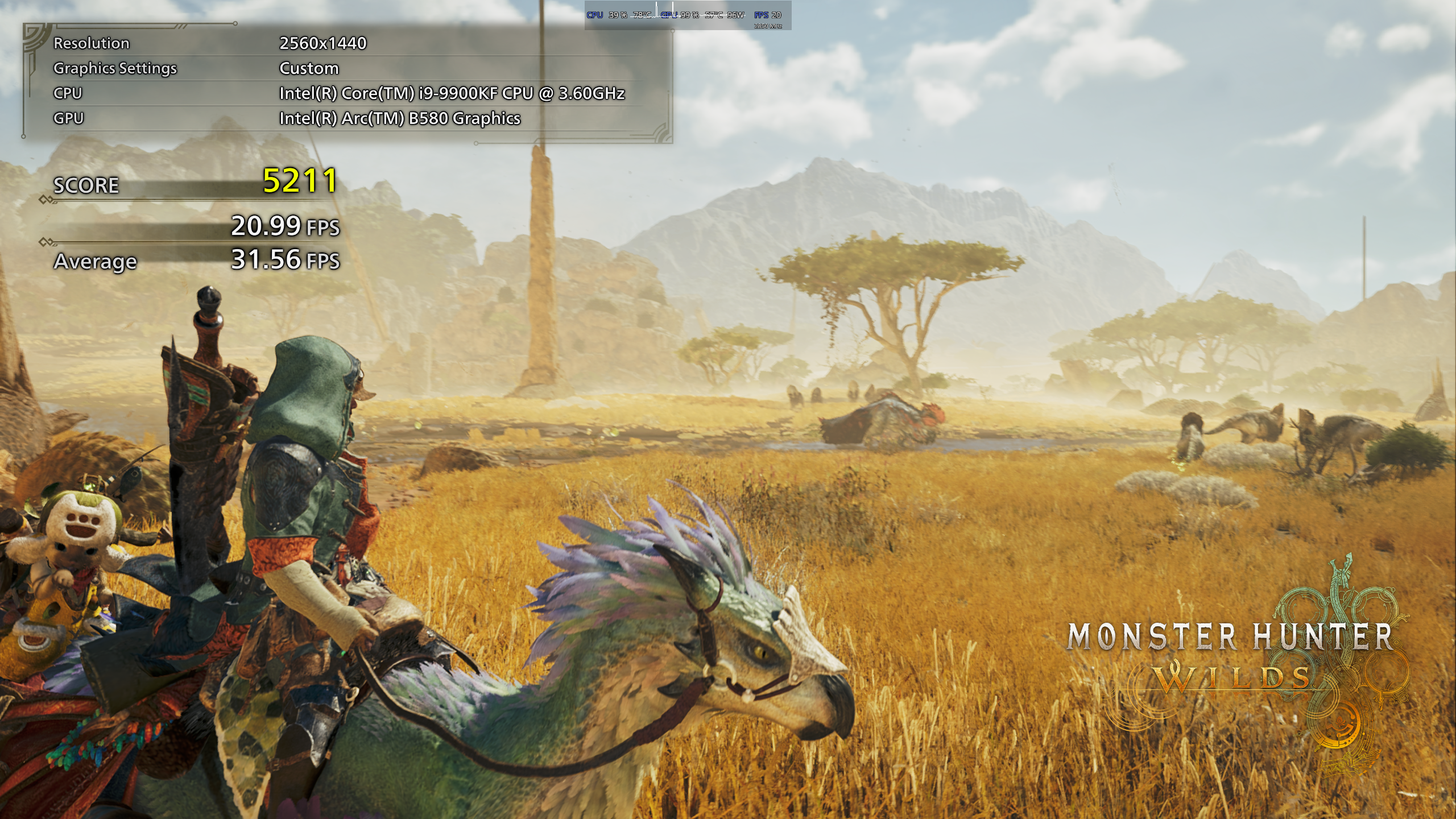

I think that Monster hunter wilds is not utilizing the full power of the ARC B580
I also think that other games are not using the full power of this card either but it is subjective.
i9-9900KF
B580
DDR4-3200
Pci-e 3.0
Before i Upgraded to the B580 i was using a GTX980TI, That card had a TDP of 250 watts and during normal gameplay when it was at max usage it would hover between 240-255 watts in any game EXCEPT MONSTER HUNTER WILDS.
In monster hunter wilds the GTX980TI only ever used up to 155W out of its total 250W TDP.
Other cards from Nvidia did not have this issue, in fact that card was equal to the GTX 1660 which was listed as the minimum specs for that game, yet the benchmark only went up to 30fps at the lowest settings, which is less then what the 1660 got by a huge margin.
Why am i bringing this up?
The Arc B580 Seems to be using between 80-105 watts of power during this benchmark, even when overclocked the card would only use 110 watts of power.

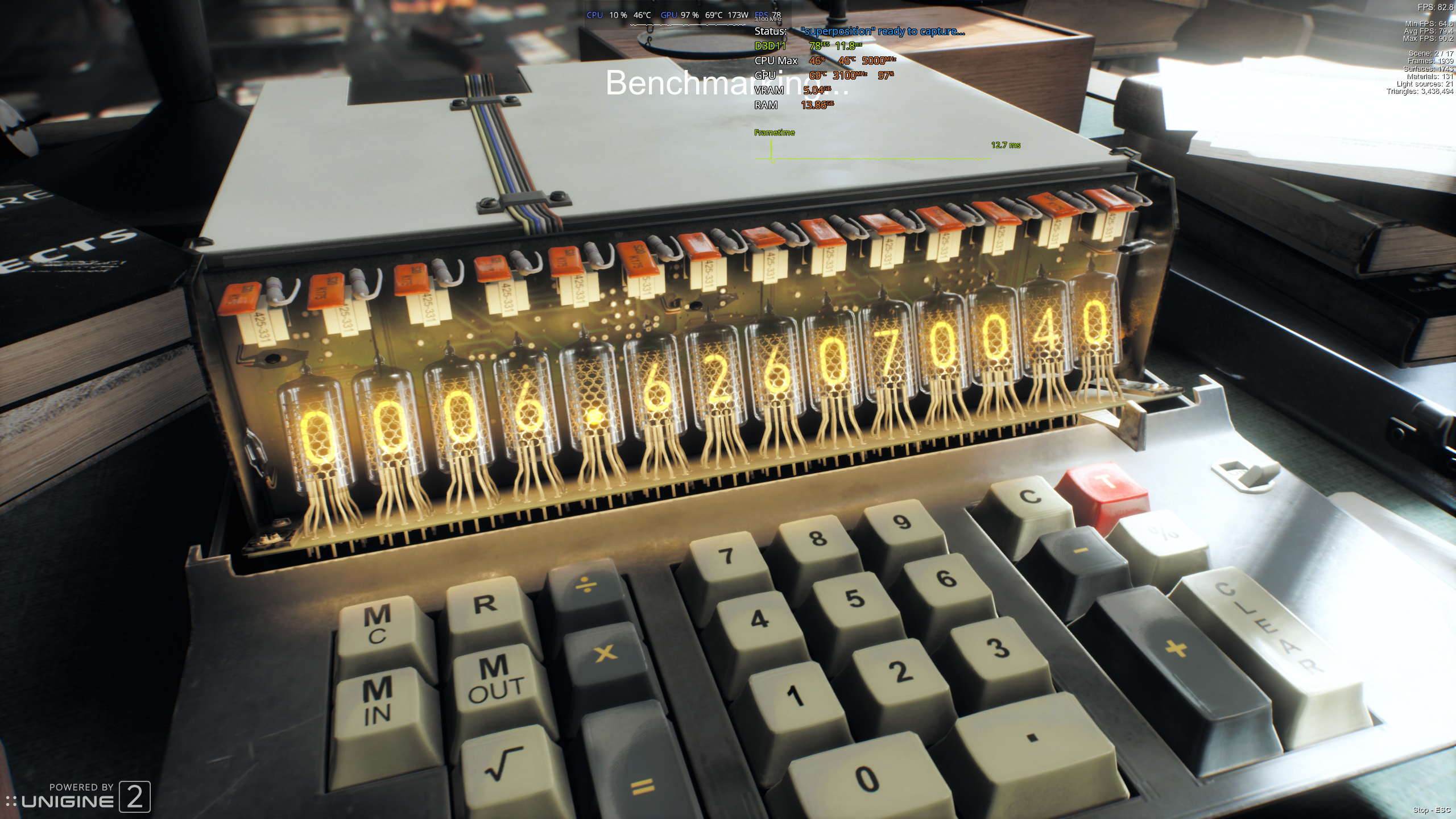

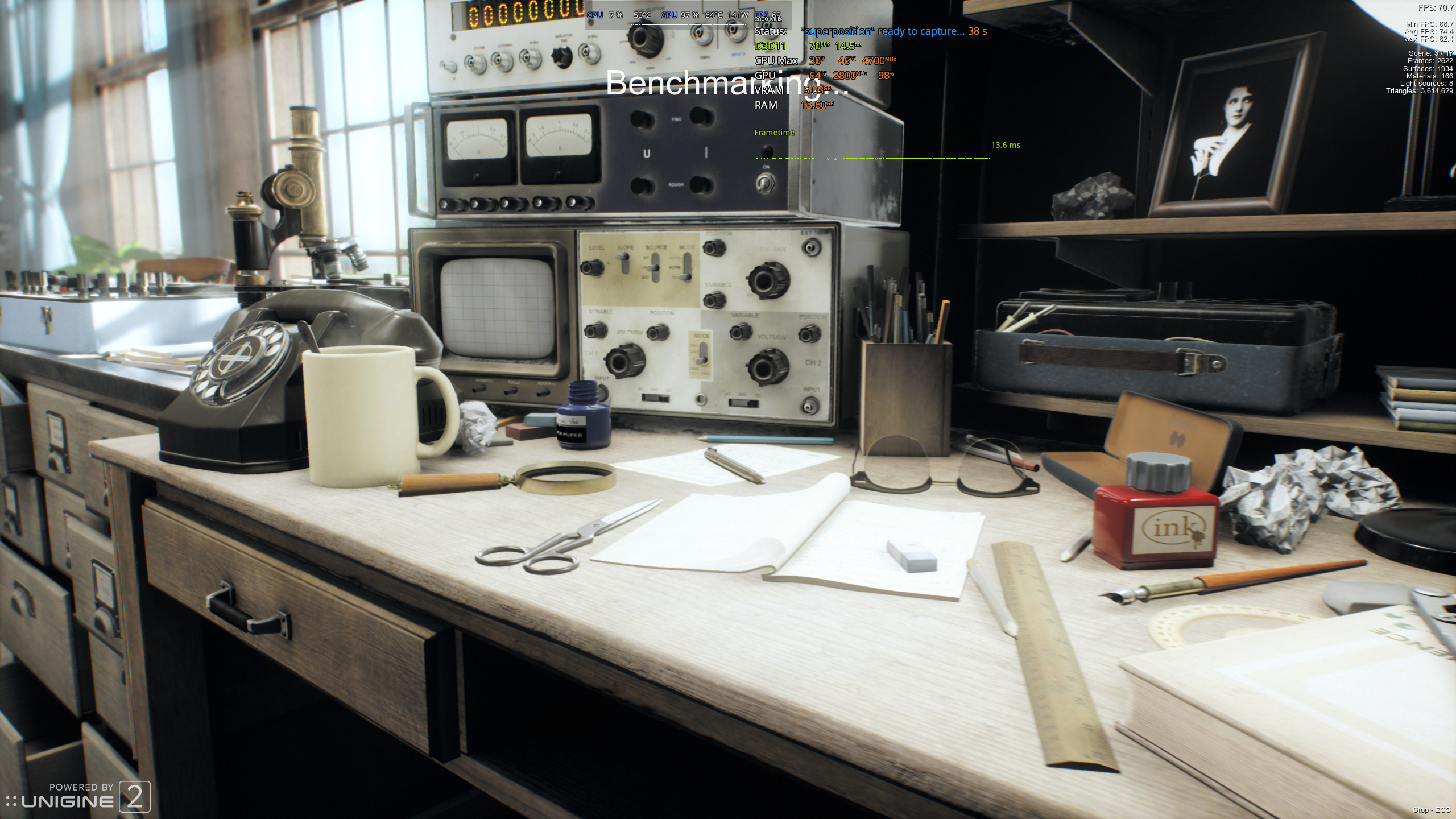

With the superposition benchmark at stock clock speeds the power usage is 140-148w
When overclocking, the superposition benchmark would use 168-174w
The B580 has much more headroom it seems but is not making use of the total power that it is capable of.
I will attach a picture of the monster hunter wilds benchmark along with a screenshot of the superposition benchmark with an overlay that shows the "reported" power at stock speeds.
I think this is something the team should look into if they are not already.
For reference monster hunter world uses around 125w at stock clock speeds.
Monster hunter games downloaded from steam.
Benchmark downloaded from the benchmark website.
*I added some benchmark power usage screenshots as examples of normal power usage vs low power usage*
I know that not all applications use the same amount of power to render scenes, but this card is only using 70% of its total capacity to render Monster Hunter wilds and 89% on Monster Hunter world for comparison.

Oh yes i had the latest drivers installed while running through the benchmarks but i reverted to older drivers to try to fix some of the other issues i was facing in other games, but it didnt change the issue. I will update to the newest version when there is a reason to.
I know my PC does not meet minimum specifications for this graphics card but again, this is not the issue here specifically as even on youtube videos on B580 Benchmarks on monster hunter wilds, it is easy to see that the B580 just refuses to use more then 105 watts of power when it is capable of more.
This is a screenshot from a youtube video showing exactly the same issue as i have shown, the card just is not using the power it has available.
Also i would like to know that My CPU (i9-9900KF) is identical in gaming performance as the i7-11700 according to performance benchmarks found on forums. (within 2% framerate difference)
I chose these frames because they have the highest power usage out of the B580 i was able to find in the video.
https://www.youtube.com/watch?v=COFEZYKN0wY
Link to the video to see for yourself.
There are also plenty of other videos with better components then mine that not only match performance but back up my claims.
Here is the power usage from a completely different channel using a better CPU
I could not find higher power usage in this video either. Mind you the power limit is 140w at stock clock speeds.
Here is the link to this video.
https://www.youtube.com/watch?v=_BIpLXrNokQ
If you need more source materials or anything else, please dont hesitate to ask.

I installed the latest driver, compiled shaders and went to the benchmark, The game does run better in some spots where before it would struggle more.
I have even played the full game now (in the beginning section for a couple hours) with the new drivers, performance is identical between the benchmark and full game as far as i could tell.
While running the benchmark on the previous drivers the highest power usage was about 105w, On the new drivers i managed to see a spike of 119w for 1 second at the beginning of the benchmark, and during the one second, performance was much better!
Unfortunately the card still played the rest of the benchmark (and the game) at less then 105w.
Seeing the performance spike with the higher power usage gives me hope still.
I used native 1440p ultra settings with medium textures and high raytracing, i saw an improvement from 30.5fps to 31.75fps on these new drivers.
I also noticed more stable framerates overall so that was very nice.
I don't know how you guys managed to squeeze out more performance without increasing power consumption, but good job overall.
