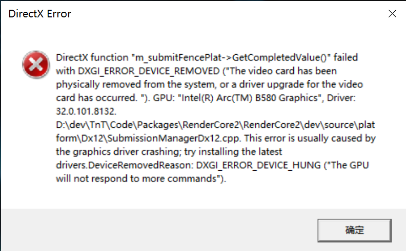

Battlefield labs will crash if low latency mode "On + Boost" set when labs program run 10-15 minutes, even not enter the game, just opened the program and stayed on the homepage. If low latency mode just "On" set is OK.
Graphics Card : GUNNIR Intel Arc B580 Index 12G
Driver : Intel® Graphics Driver 32.0.101.7028

Yes, after half a day of testing, the issue consistently happens every time I run Battlefield Labs with the "On + Boost" mode enabled via the "Graphics" settings. However, if I enable "On + Boost" specifically for the game through the "Profiles" settings, the problem doesn’t occur (tested multiple times, each session lasting at least 45 minutes or until a crash would normally happen).
I haven’t tried adjusting other graphics settings yet, like turning off other performance enhancement features. Most of my other settings are on AUTO.
When low latency mode is set to "On + Boost" via the "Graphics" settings, no similar crashes happen in other apps or games. For example, Battlefield 2042 runs perfectly fine with it — actually feels a lot smoother.
I’m on the latest Windows 10 with all updates and chipset drivers installed. I also clean-installed the latest Intel graphics driver (version 32.0.101.8132, WHQL certified) using the Intel DDU tool. But the original issue still persists, and now another new problem has started showing up — the two issues take turns occurring.
(By the way, my PC only has one partition — not even a D:\ drive haha.)
Battlefield Labs automatically generated some crash dump files, which I’ve attached. Hope they help. If you have any questions or need more info, just let me know. I’ll also start checking the Intel forums by myself when I have time.
