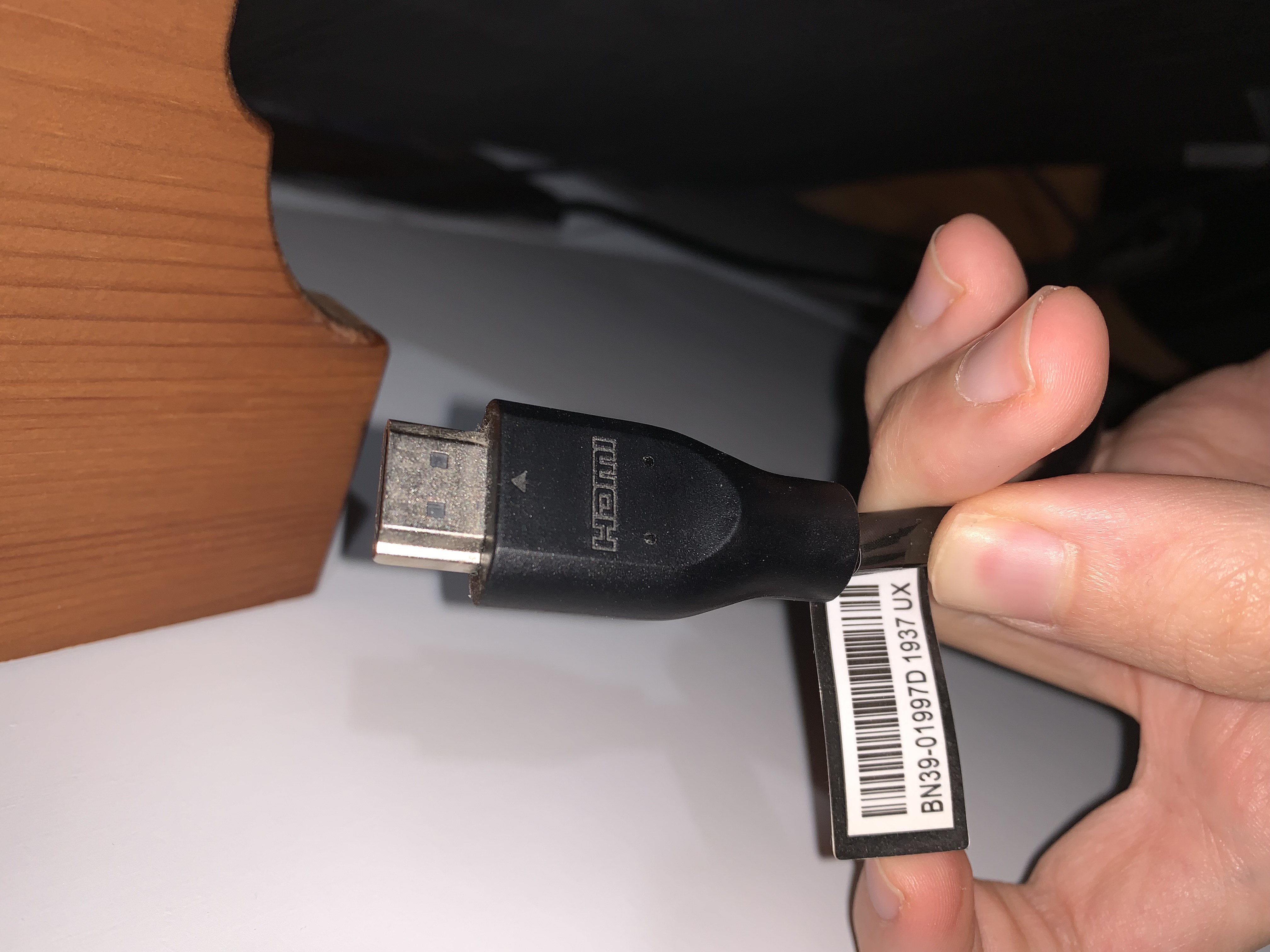

thank you for reaching me in this discussion. EVGA 850 GQ, 80+ GOLD 850W, Semi Modulare, EVGA ECO Mode, Alimentatore 210-GQ-0850-V2 that's the PSU i'm using since i built pc. and for th HDMI i'm not pretty sure what model is it; for this reason i'm attaching 2 pictures of it. Thanks again for your help.

Hi @Scafatiello,
I agree, yes, this is clearly a monitor issue, not related to bandwidth or PSU, as both components are supported by the GPU.
To resolve this, try using a different monitor that supports HDCP 2.2 and HDR (especially if you're streaming in 4K).
However, you may also try the recommended troubleshooting steps by @Olivia342 for further isolation.
I’ve attached a cable version that supports your GPU for reference. You can try using this type of cable for further isolation and testing.
If you need more information, feel free to ask. Otherwise, please let me know if I have your permission to close this thread.
