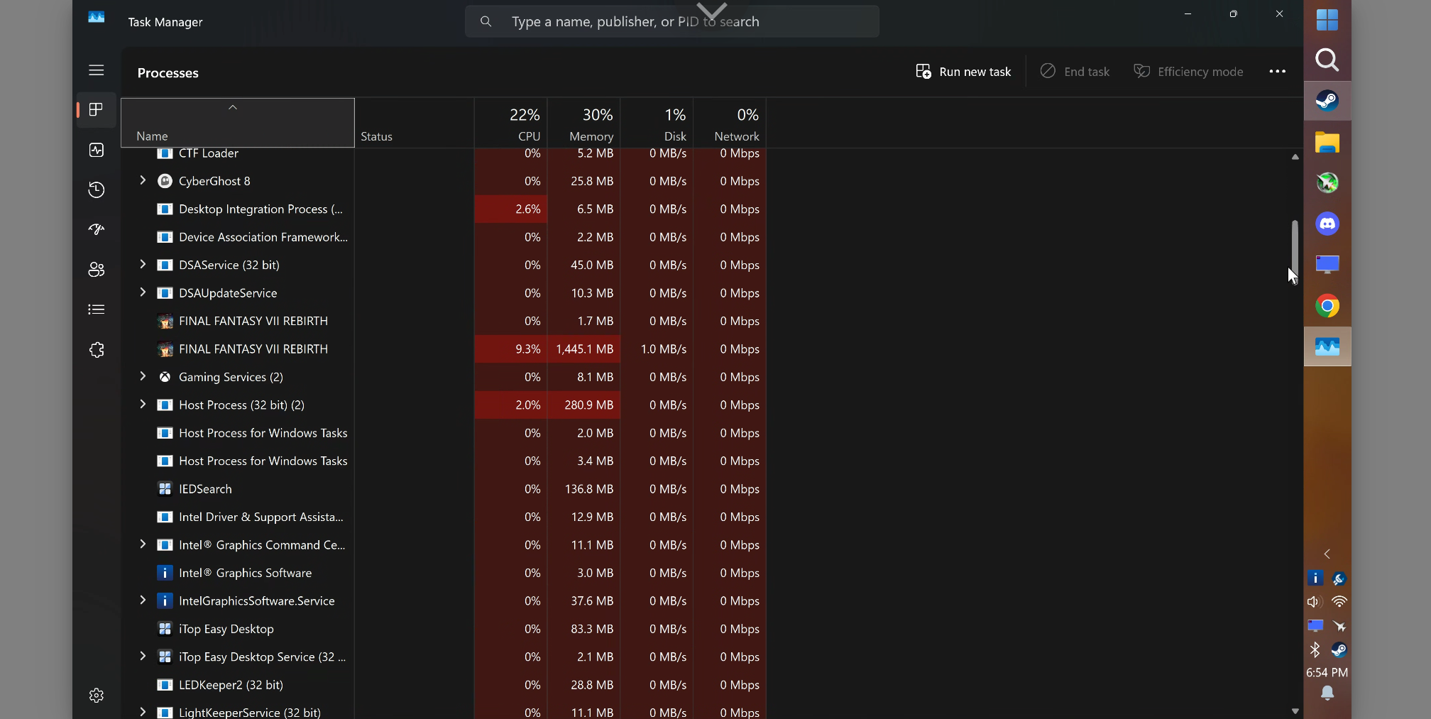

On version 6647 it will not open, I do see a background process in the task manager, but the game will not appear on screen. The game opens fine with version 6559. I have not used version 6632 because I've only been using the WHQL Certified drivers. I bought and downloaded the game from Steam. Thank you for responding.

So I went ahead and updated to 6651 and unfortunately those drivers failed when launching the Final Fantasy 7 Rebirth. I noticed that it did have 2 processes running in the background in my task manager, but the game would never appear on screen and no audio of the game could be heard either. Some things I did while I had the drivers installed was go into my windows settings and select for the program to use the Arc B580 as the dedicated GPU in the advanced graphics settings. I ran Steam in administrator mode. I also reinstalled the program and nothing seems to work. I then reinstalled 6559 and the game launched without a problem. Unfortunately the problem persists with the latest drivers. Thank you for investigating this. I'm also attaching the screenshots of the background process.
Hello liongriver,
Thank you for the update and for letting me know that the driver update did not resolve the issue. Please allow me some time to investigate this internally. Once I have more information, I’ll get back to you.
Since you mentioned that the games are launching using driver version 6559, please provide a screenshot of the settings for replication purposes.
