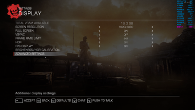

So the game launched with intel arc cards in the requirements, yet the game is completely unplayable on an A770 16GB card. Install and play it through either steam or the Microsoft Store.
Gears of War Reloaded is stuttering, freezing, and dropping from 100+fps to less than 5 fps.
I included the intel ssu output and uploaded it as well.
Here is a video example of the issue as I experience it.
Note how CPU usage spikes to 90+% when it stutters and drops frames.
I also believe that the video caught the audio skipping as well.
Gears of War Reloaded Poor Performance - YouTube
I do hope that we can have this issue fixed sometime soon.

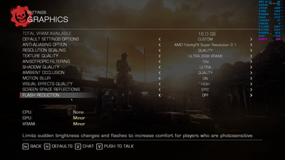

I've tried all graphics settings, the hitching and frame dropping never stops, but the framerate in the minute seconds between gets better as the settings go down. towards low. I've tested this extensively with both the release build and the open beta they did like 3 weeks ago.
Screenshot of the settings as follows:
This issue is only present while the game is rendering a 3d scene (so any time you can actually play the game). Menus work fine and the hitching doesn't seem to be present until you start playing. But yes, its starts immediately and doesn't ever go away.
