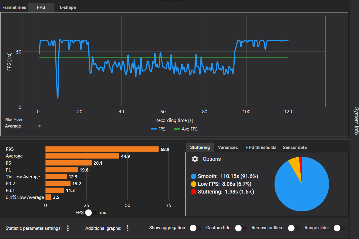

On the Asus ZenBook 14 UX3405MA running the core ultra 7 155h, when playing a game, GPU performance tanks during any video playback at any resolution. All drivers are up to date. using the most up to date version of windows and chrome. The issue is not one of performance as the integrated GPU is more than capable of performing both tasks.
Note: When disabling GPU acceleration in the browser the issue disappears.
Does anyone have any explanations or solutions? Is this simply an arc driver thing?

Thank you for reaching out. I would be happy to give you as much information as you would like. To be more specific when playing back a video in chrome (youtube, twitch, etc). The Frame Times in select games get significantly worse with much more hitches and inconsistency. GPU usage & clock speeds don't seem to change when inducing the issue. Pausing the video or minimizing the window immediately alleviates the problem as does closing the browser. Resuming the video immediately resumes the problem. Very binary and very consistent. Can recreate without fail.
*thing to note is the video can be played so long as it's minimized or you have switched to another tab. This will not induce the issue.
*This is also irrespective of the resolution. There is no trend between load of the video and the amount of performance lost.
*This issue continues whether the game is full screen or windowed on another monitor or covering the video as it's playing.
*screen recording using windows snipping tools built in recording feature also causes the same perf issues during the recording
1. The issue is most prevalent when playing Minecraft: Bedrock Edition on windows which should be using
The game's "render dragon" engine which uses DX12. I did notice similar issues in Valheim when using vulkin but to a lesser extent and it did not show up when using DirectX 11. No other games were tested as these are the only ones I have installed.
2. While this laptop is a thin and light form factor machine and doesn't run the coolest. I have replaced the thermal paste with liquid metal and used thermal pads to assist in cooling the chip. The temperature of the gpu does not correlate with the issue at all and is independent of it.
3. Using Chrome the issue is 100% recreatable but when using edge (also chromium based) the issue doesn't seem to exist at all.
*A clean driver installation was done as well when troubleshooting. Various settings in the graphics menus were tested too (eg. turning off low latency mode)
*Since screen recording itself causes the issue I decided to just show the choppiness I was experiencing. The effect in the video is indicative of what it is like during regular video playback

ChrisAllard
4,471 Views
Hello, sorry for the late response.
As mentioned earlier when using the edge browser the issue does not occur, only on chrome.
Here is the CapFrameX data. 1 file was taken at a cap of 120fps by setting the refresh rate of the display to 120hz. The other file was taken at a capped frame rate of 60. As you can see in both configurations there is a clear valley in the framerate and a spike in the frame times during the run. This was directly caused when i would play and pause the video.
The OEM driver is from 2022 and, as such especially for arc, is hilariously out of date at this point. I did not test with that driver.
