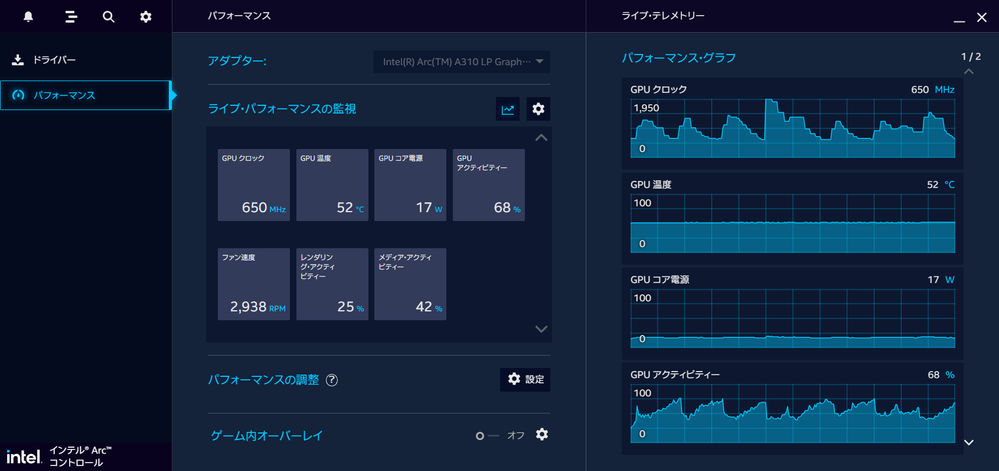

yosiox
11,685 Views
Hi Alfred.
I've uploaded some screenshots, a recording of the fan noise, and the SSU log.
noise when the fan speed fixed seems to be "slightly better" than before.
In the case of fan speed auto, it still makes noise (like waves).
A310 is running AV1 hardware encoding with OBS.
system info, IFWIsystem info, IFWIGPU clock, temp, ActivityGPU clock, temp, Activityfan speed, etc (fan auto)fan speed, etc (fan auto)fan speed, etc (fan fixed 30%)fan speed, etc (fan fixed 30%)

yosiox
11,290 Views
hello...
All users reporting this issue are wondering:
"why does Intel Arc Control not have the function to fix the fan speed?"
"why minimum target is 30%?"
"why does it stop the fan when temperature drops below the threshold?"
in the case of Sparkle A310LP ECO at 30% fan speed from 0 to 3000 rpm.
in my use case if lock fan speed at 1500 rpm, GPU temperature should be below the threshold.
we no need to change fan speed automatically.
don't stop the fan.
