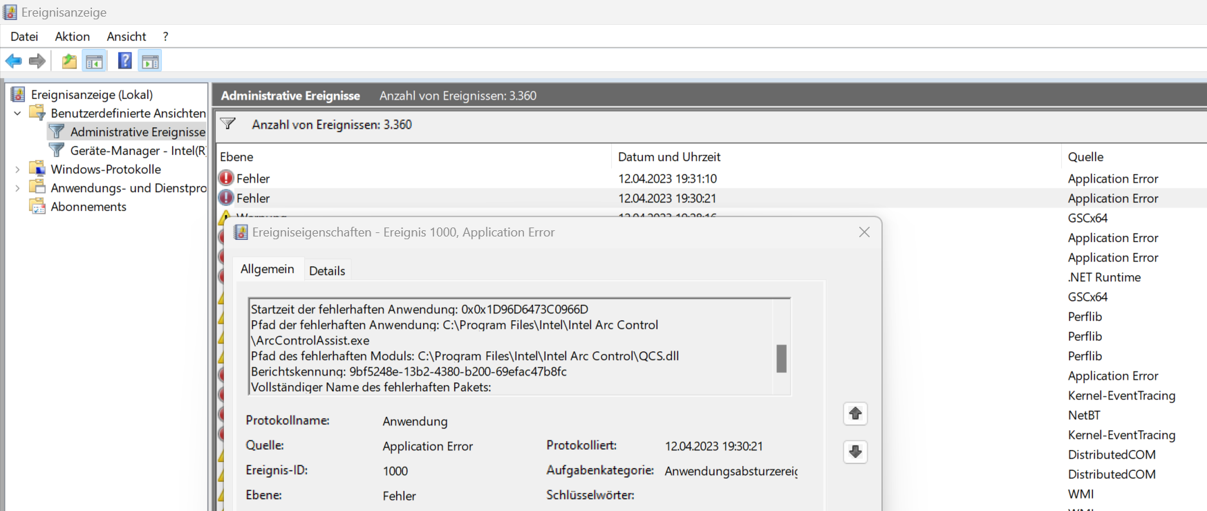

But the software Arc Control will not work. I installed the latest driver many times, also with a clean install. But after launch the software, no input with keyboard or mouse is possible.
I could detect in the windows event viewer a interesting message, and it seems for me that the the
QCS.DLL is defekt or incomplete (please find a hardcopy about this as attachment).
Has anyone an idea how to fix this dll or where can I download this dll file. Possible this could solve my problem!?

- Same error in event viewer regarding ArcControlAssist.exe and QCS.dll as shown in my screeshot before
- I am able to start the Arc Control, can move the window with the mouse, but no inputs are possible

- then I go to the windows event viewer again and find consistently a application error with the following content:
(this seems to me as an error in the qcs.dll, it has the same size in version 4255 as in 4257. I assume, that not the installation is the problem, but anything is missing in the qcs.dll, necessary for my system. But the windows installation is very new and I would think it's very near to standard)
Name der fehlerhaften Anwendung: ArcControlAssist.exe, Version: 1.66.4728.1, Zeitstempel: 0x640a394e
Name des fehlerhaften Moduls: QCS.dll, Version: 2023.2.21.519, Zeitstempel: 0x63f4c57e
Ausnahmecode: 0xc0000005
Fehleroffset: 0x000000000003a6f1
ID des fehlerhaften Prozesses: 0x0x5714
Startzeit der fehlerhaften Anwendung: 0x0x1D96E450B45F756
Pfad der fehlerhaften Anwendung: C:\Program Files\Intel\Intel Arc Control\ArcControlAssist.exe
Pfad des fehlerhaften Moduls: C:\Program Files\Intel\Intel Arc Control\QCS.dll
Berichtskennung: f8fd9828-c499-44ce-9d0c-a7efbf9b070d
