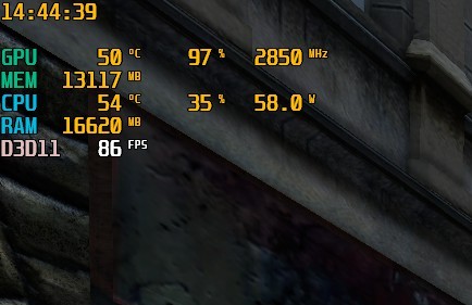

I am having trouble in DayZ (Steam). The game will start and work perfectly, but overtime the game will use more and more VRAM until it exceeds the card's capacity and dip into shared memory. The FPS will then proceed to decline, especially in cities. Areas that I had already visited with 200 FPS will now have below 100, down to 30 FPS. This is on official servers as well.
System specs :
CPU : AMD Ryzen 5 7600X 6-Core Processor
RAM : Corsair 32 GB (2 x 16 GB) DDR5-6000 CL30
GPU : Intel ARC B580 LE
MOB : MSI MAG B650 TOMAHAWK WIFI
PSU : Corsair RM750 (750W)
SSD : Kingston NV2 1TB
OS : Windows 11 Home
I have made sure the recommended settings are used (ReBAR, High performance power plan, ASPM Max.) and my current driver is 6874. The PC is a few months old, being built with the B580. BIOS is up to date, as is chipset drivers.
Solutions I have tried :
Uninstalled and reinstalled DayZ
60 FPS limit
Smart VSync/Low Latency Mode
Clean reinstall of windows
Clean install of drivers with DDU
Tested on old driver (6651)
Disabled iGPU in BIOS
Lower game resolution (Still occurs)
Lower in-game graphics (occurs even with all at low)
Windowed mode
I will attach screenshots of my video settings and FPS/Memory usage in official servers.
Another thread described this similar issue but was closed: Here
Cheers,

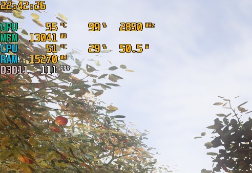

Official servers are stock DayZ, while I do have mods installed to play modded servers, official servers will not load these mods.
However, just to be certain, I uninstalled all my mods and did another test on official servers and there is still overflow and performance drops. Screenshots below.
I wouldn't say 5 hours is necessary since I took a few breaks during that run, 3 hours is probably more accurate. On modded servers, the VRAM overflows quite quick, often within 30 minutes which makes them quite unenjoyable. However, I kept my tests on official to wipe mods of culpability.
I have not reported it to the game developer since my friends with other graphics cards, such as a 4060 and 2080, do not have the issue.

I have not crashed when the VRAM leak occurs. After leaving the game on for a long duration, reaching up to 20 gig memory, the game still did not crash.
