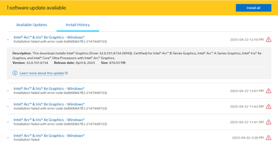

I am using Arc A750 graphics card. After my game (POE2 - 0.2.0f) started crashing constantly a little time longer after I start the game, especially on some specific visual effects, tried to check my drivers are up do date or not and I realized that Intel Arc Drivers were keep failing lately.
You can see the update log below:
Either by doing it through the install button in the help center or opening the downloaded installation file for drivers, it kept closing itself after extracting process. Following screen completed successfully:

I just factory reset my drivers and Windows 11 clean. I was able to install the latest graphics driver and also POE2 game crash problem has been solved accordingly.

Hi BerkayC,
Thank you for posting in the community. Let's start by addressing the update issues you're experiencing with the IDSA. If you wish to update your graphics driver to the latest version, please perform a clean installation using Display Driver Uninstaller (DDU). First, download the latest graphics driver (32.0.101.6734). After that, follow the steps below. Please note that once you download DDU, you should complete the remaining steps while your system is disconnected from the internet to prevent the automatic installation of the previous graphics driver.

I followed the steps exactly as you described, however after DDU rebooting the system I got the same response as previous upon starting the driver file I downloaded. I was disconnected from the internet before I click on DDU extract program. Also tried to install from driver assistant after that, got the same response again. Now there is no driver from Intel is installed on my system and I also lost my voice output on my monitor.
