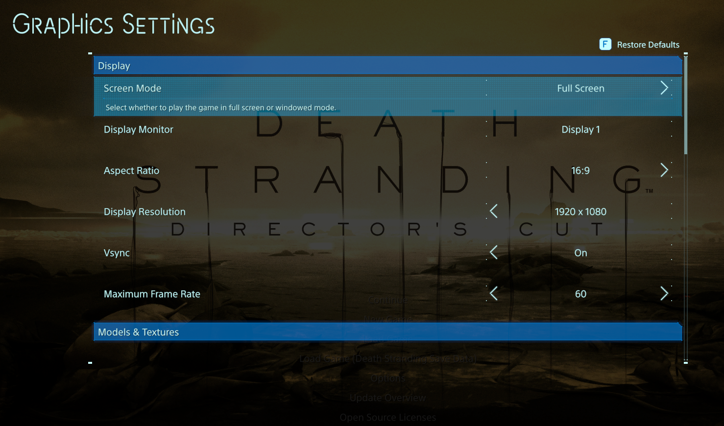

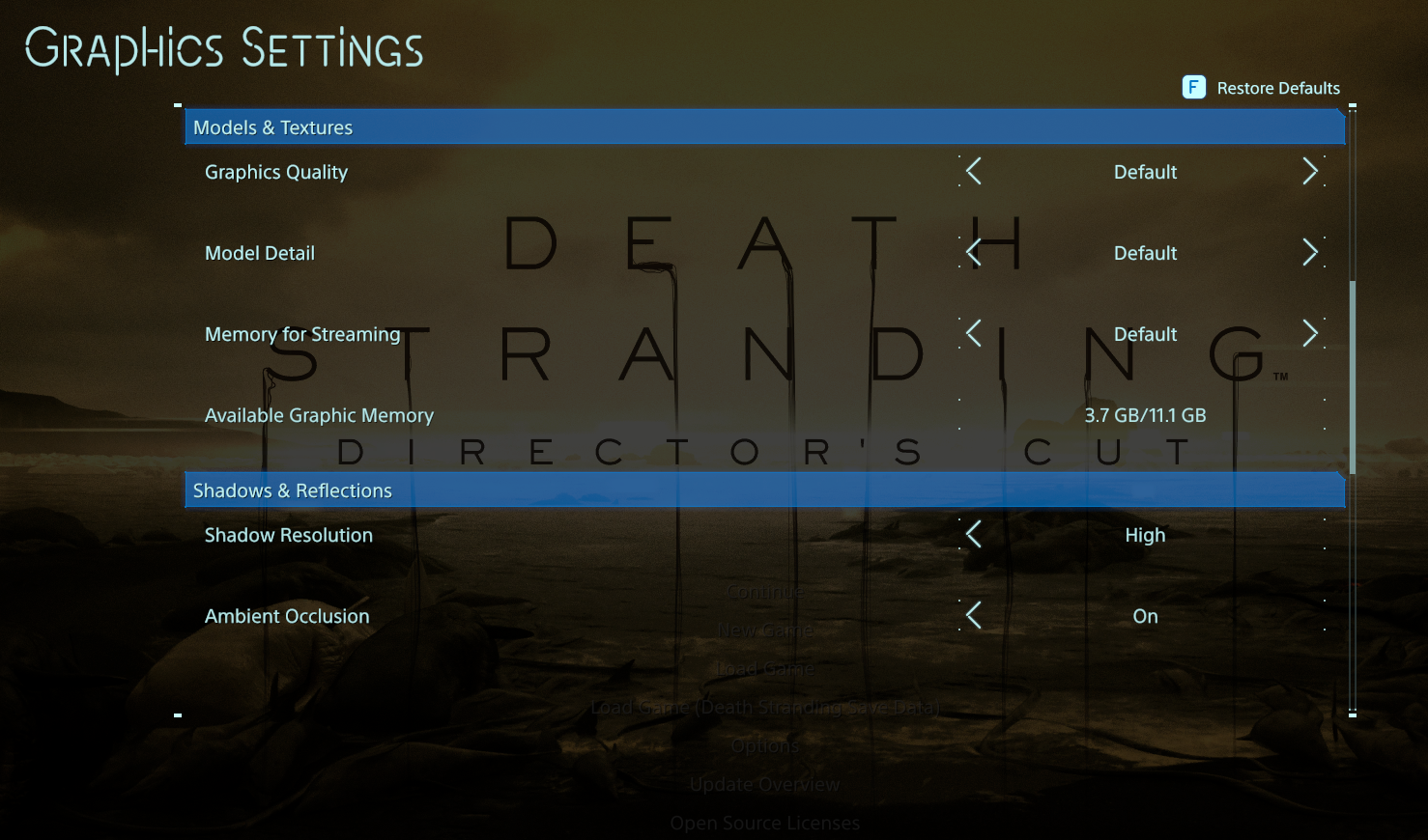

Attached are my graphics settings for Death Stranding.
However, as I mentioned earlier, it might be difficult to reproduce this issue since it may occur within half an hour, but may take many hours as well. Since it was not too often and predominantly while interacting with in-game menus, I actually managed to finish Death Stranding on B580. Though my SSDs report about 25 unsafe shutdowns due to hard resets.
