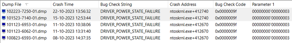

With Chrome or Edge open, I'm seeing an intermittent flash of black - the whole screen blacks out for a fraction of a second.
It's so brief that, for a while, I wasn't actually sure if the whole screen was blacking out, or just the browser window - I'm certain now that it's the whole screen.
I was running Windows 10 Pro, and the issue was happening there as well - about a week ago, I did a clean Windows 11 Pro reinstall, hoping this would fix the issue, but it still happens.
It seems to happen only when Chrome or Edge are open - it does not appear to happen while gaming, but the only game I have installed at the moment is Horizon Zero Dawn. It crashes or reboots every now and then, but this game is somewhat notorious for crashing a lot, so I'm not too worried about that.
I've never seen this black flash while playing though - which makes me wonder if whatever is causing the black flash could also be causing the game to crash? I have sometimes played with Chrome open in the background, so I wonder. Crashes happen sometimes after several hours though, so I can't say I've noticed a pattern.
I read a post somewhere from someone else with the same issue - they said they upgraded their BIOS and that fixed it. So I've upgraded my BIOS to the latest version, but it still happens.
I figured maybe there was a memory problem, so I've underclocked my memory from 6400 to 4800, but that also didn't help.
I'm on a week-old, fairly clean Win 11 Pro system - the only things I've installed are Epic Games and Horizon Zero Dawn. I also have Chrome, WSL 2 and VS Code, MS Powertoys and Stardock Start11, and not much else yet.
I've been having a few BSOD crashes from my Windows desktop as well, while browsing or working in VS Code. It doesn't seem to be related to what I'm doing.
I ran memtest86 earlier, for a whole day, with my memory still set to 6400 like it says on the sticker, so I'm fairly certain my RAM is good.
The system itself is fairly new - here's my configuration:
- Windows 11 Pro 10.0.22621 Build 22621
- MSI MAG B650M Mortar WiFi (model MS-7D76)
- AMD Ryzen 9 7900 (non-X, not-overclocked)
- RAM: G.Skill Ripjaws S5 DDR5 2x16 GB, DIMM 288-pin, 6400 MHz / PC5-51200, unbuffered, CL32, 1.4 V, non-ECC
- BIOS Version/Date American Megatrends International, LLC. A.65, 02-08-2023
- SMBIOS Version 3.5|
- BIOS Mode UEFI
- HP X34 display at 3440 x 1440 and 165 hertz HDR10
- Arc Driver Version 31.0.101.4577
- Onboard graphics disabled
So it's a fairly clean and vanilla system, which might be helpful.
Please let me know if there's anything I can do or provide to help diagnose the issue.

I analyzed the dump file and the crash root is located in Failure Bucket ID: "0x9F_3_IMAGE_storahci.sys" related to the Windows Storage driver (i.e. disk drives) and doesn't relate to the Graphics driver or graphics hardware.
Some basic recommendations would be on the motherboard side:
  • Download and install the version of chipset drivers.
  • Check for any Intel driver installation like Intel Rapid Storage Technology.
For guidance, you can contact the motherboard manufacturer.
Let me know i the issue persists.

So yeah, it's still crashing - though the kernel address seems to have changed, but I suppose that could be due to the most recent Windows kernel update, which I think arrived right around the same time I installed the drivers.
Do you have any idea how to get in touch with MSI or how to approach them about this issue?
