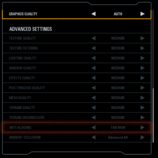

Hi Owen4,
To help isolate the issue, please disable DirectX 12 in your game settings, as the screenshot you provided indicates that it is currently enabled. This step will help determine if the problem persists. There is a known issue were enabling DirectX 12 with the B580 can lead to visual artifacts in games. I am actively working to resolve this issue with our B series and need to ascertain if it is related to this setting. For additional information, please refer to our article titled "Star Wars: Battlefront II* Visual Corruption with DirectX 12 on Intel® Arc™ B580"

Hi Owen4,
When did the issue start? Was it after a specific driver update or game patch?
What are the troubleshooting steps that you tried so far?
Is the Resizable Bar enabled?
Have you used DDU to completely remove all residual drivers and installed a new one?
Have you tried adjusting the graphics settings?
Have you tried updating the BIOS?
Could you provide a screenshot of your in-game display and graphics settings?
Archie D.
-These glitches have been present since I started playing the game.
-Resizable Bar is enabled
-I have not updated the bios recently
-I have not used DDU
-I have not done any troubleshooting beyond updating my graphics driver
-I have not adjusted the graphical settings, I left them on auto.
-I will attach screenshots of the settings and the SSU report.

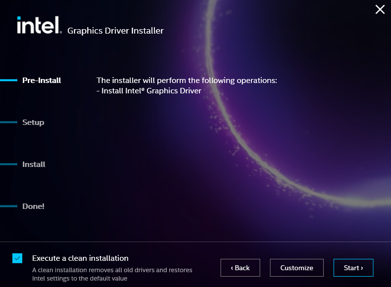

Hi Owen4,
Thank you for the feedback. I checked your SSU and saw that the BIOS is not up to date. please try first to update to the version 02.95 Rev.A.
Additionally, please try performing Display Driver Uninstaller (DDU).

I have updated my machines bios and that did not seem to affect the problem any. I also saw there was a driver update and saw there was a execute clean install option. I clicked that but it does not seem to have affected the problem either. I can also use DDU to be safe if you want.

I disabled the DirectX 12 setting and I have not seen glitch 3 with the blocks on screen show back up. Glitch one with the random switching between bright and dark also seems to have been fixed though it does seem a bit to bright. I have attached a picture of what it looks like now. Also I found another map where the glitch one was occurring but have not been able to get a match of it since switching off DirectX 12. When I get a match on the map, I'll tell you if its fixed there also.
