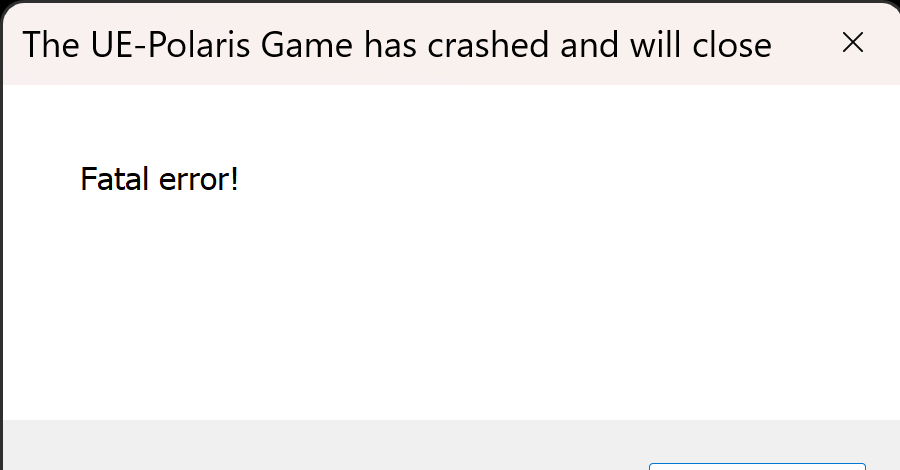

Dear Randy T.
1. find screenshots in attachments. I wasn't sure which steam settings would you like to see so I have done only in game settings section, can you specify please. Tekken 8 game crashed on Xess while I was playing with setting after getting white screen for change in main menu. everything including error screenshot is attached.
2. I have installed the latest drivers using DDU in safe mode.
Kind regerds
Tomasz K.
