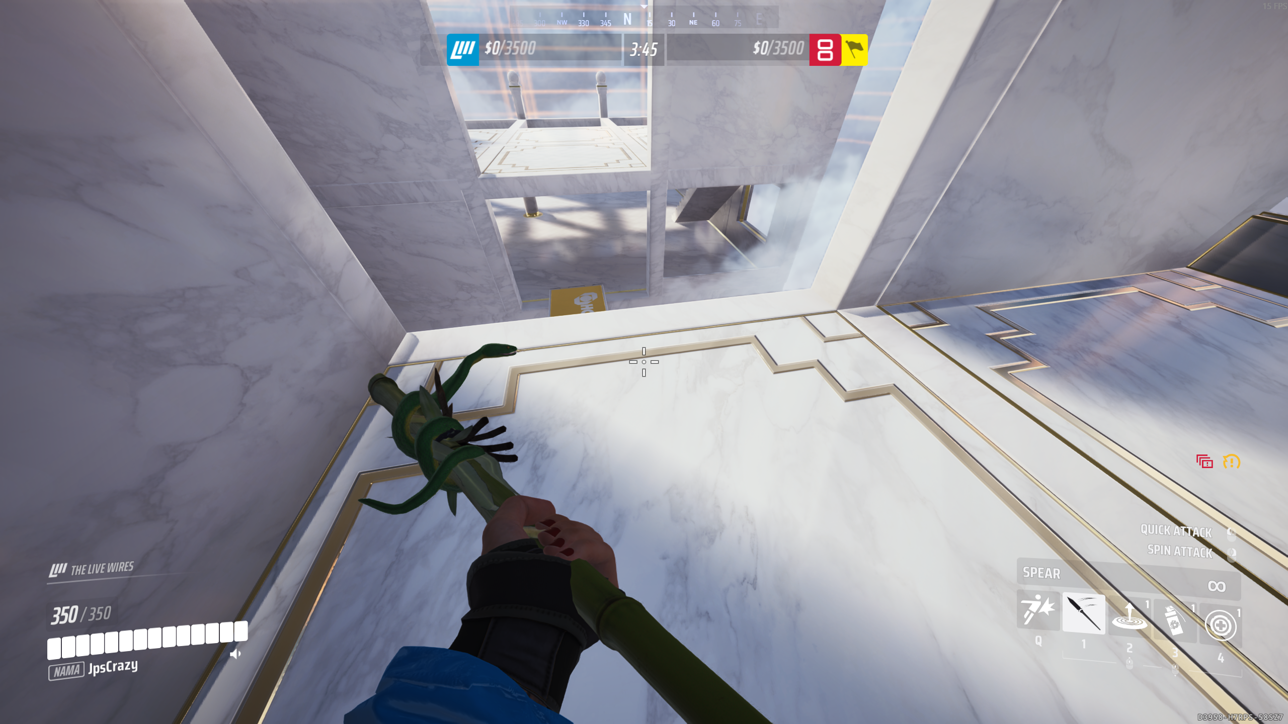

In the game The Finals for PC on Steam, the new map for the limited time mode Heaven or Else has significant FPS drops when you look down.
Other reports all occur for Arc A series cards.
Normally get 80-100 FPS, and if I keep my camera up I can maintain that in the new map, but as soon as I look down my FPS tanks to <30 FPS, persists as long as I'm looking down, and returns to normal after I look up. Its at its worse when I'm in the air and have a clear view of the lava.
Cleared shaders, updated drivers/PC, restarted, turned off XESS, set XESS to ultra performance, adjusting game settings, attempted windowed mode, etc.
FPS in top right of gameplay screenshot; private match, only difference was the angle I looked at.

Please find my SSU log attached.
Confirmed, the FPS drops are only this impactful/consistent while looking down in the Heaven or Else map. I may experience some FPS drops otherwise, but I'd be shocked if they dipped below 60 FPS (compared to 15FPS here)
Confirmed I'm using 32.0.101.8135. I'll attempt to uninstall with DDU and reinstall.
Attached is CapFrameX data, however I'm not able to attach .json files to this forum so I've appended .txt.
