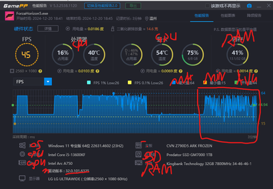

this weekend .I open my computer and run the minecraft(modpack) but I found out the fps is not good the game is always cotton.when i Focus on the fps I found out the fps always 50fps.but in normal it will 60fps(because of i open the freesync).and then i opened the Forza Horizon 5.i found out the fps always turn to 20fps.in normal the lowest fps is 40.and this cutton is suddon.so i Try rolling back to the previous driver version and resetting it.this problem is not slove.I think this is a bug? or this is my problem?
  this is some information

i am solve it i use ddu clear the driver
