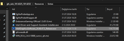

extract to folder-Resources-Extras

I used 7zip to open the EXE (install 7zip, right click on the Drive EXE, open with 7zip)
Find the "Extra" folder in the 7zip browser, extract it.
run the intel graphics software installer from the "extra" folder that you extracted.
If it says its installed I would just uninstall it with the graphics software installer exe and then run it again to install.

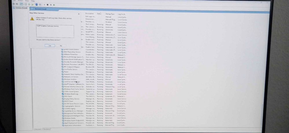

i fix it on myself i should not disable event log service on windows if disable this service i cant install or run intel grapichs software i dont know why

1- windwos event log

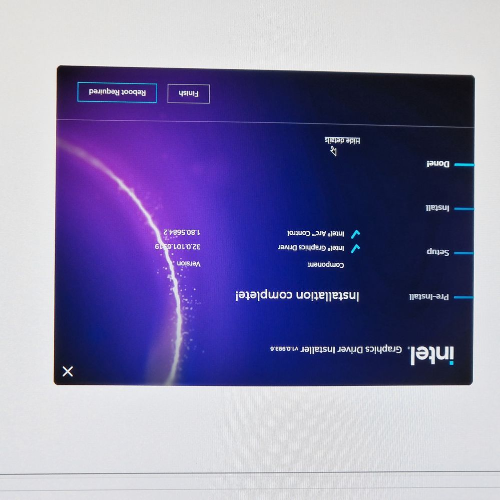

3- The driver install but Intel Graphics Software not installed
