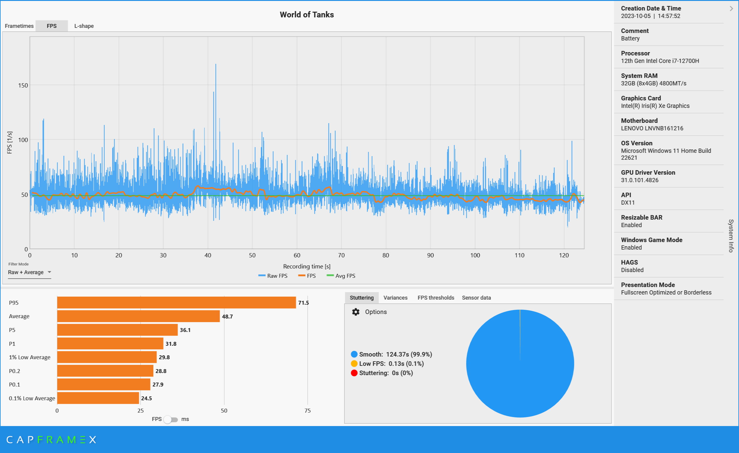

Hi, I`ve just bought a HP Spectre X360 16 with Core i7 1260P - 32 GB RAM 2 TB SSD. First day tried to test a simple game to see how it performs. I have a Microsoft Surface Laptop Studio with RTX A2000 50W TDP, playing World of Warships in 4k max settings FSR 1.0 at around 45 FPS , also have a Spectre X360 15 with a GTX 1650Ti, plays around 33 FPS and 40 Watts TDP. To my surprise, the new Spectre with the ARC A370M plays it at 19 FPS at only 30 Watts. This GPU should be at minimum 35 Watts going up to 40 Watts, just like the 2020 Spectre with the GTX 1650Ti and the 2021 with the RTX 3050. Did HP gave a shot on it`s own foot with the ARC GPU? Or there is a solution? P.S: All the settings were on the highest possible.
Any ideas or should I sell it?
Thanks!

I want to let you know that we tested driver 101.4826 on our A370M (Lenovo Yoga i7 16IAH7) and did not observe the low-performance results you are getting on World of Tanks (1080p Ultra quality preset - Average 53 FPS with frametime). We tested on battery and power modes - TDP of the card is 25-35 Watts during gameplay. Check below the CapFrameX raw files. If you do not have access to the first file you can check the screenshot.
Suggest checking in Windows -> Graphics -> to confirm the game is running on the A370M and not the integrated graphics.
