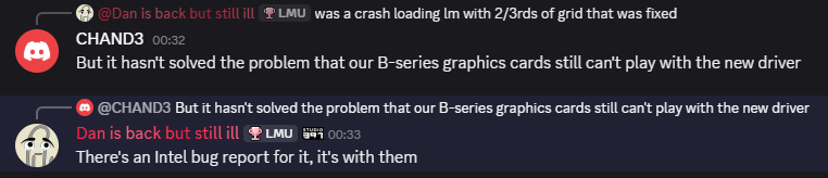

Why hasn't Intel been able to solve this problem until now, which has been ongoing for over six months. Then the game studio has made changes, but the problem still cannot be solved. The game developer has already explained that this is your problem, and Nvidia and AMD graphics cards have no issues in this game!

I have tried DDU to reinstall the new driver, but to no avail. I have also enabled the bar function. Additionally, it seems that only the 6262 driver version can run this game. The game manufacturer has already informed us in Discord that this is an issue with your driver, and they have resolved it through an update. Only you are left. This is the response from everyone on the game forum.
Known Issue - [CRASH] Unable to play - all races crash at 100% loading (Intel ARC card) | Page 7 | Le Mans Ultimate Community
Shaodichan
1,779 Views
I have tried updating the latest driver, but the game still crashes when the event loads to 100%. You promised to fix this issue in the GitHub link, but until now, there has been no change to the problem
