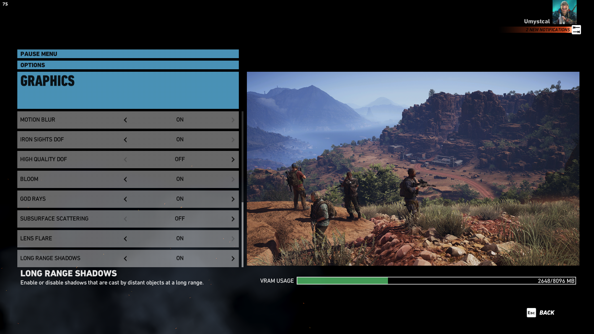

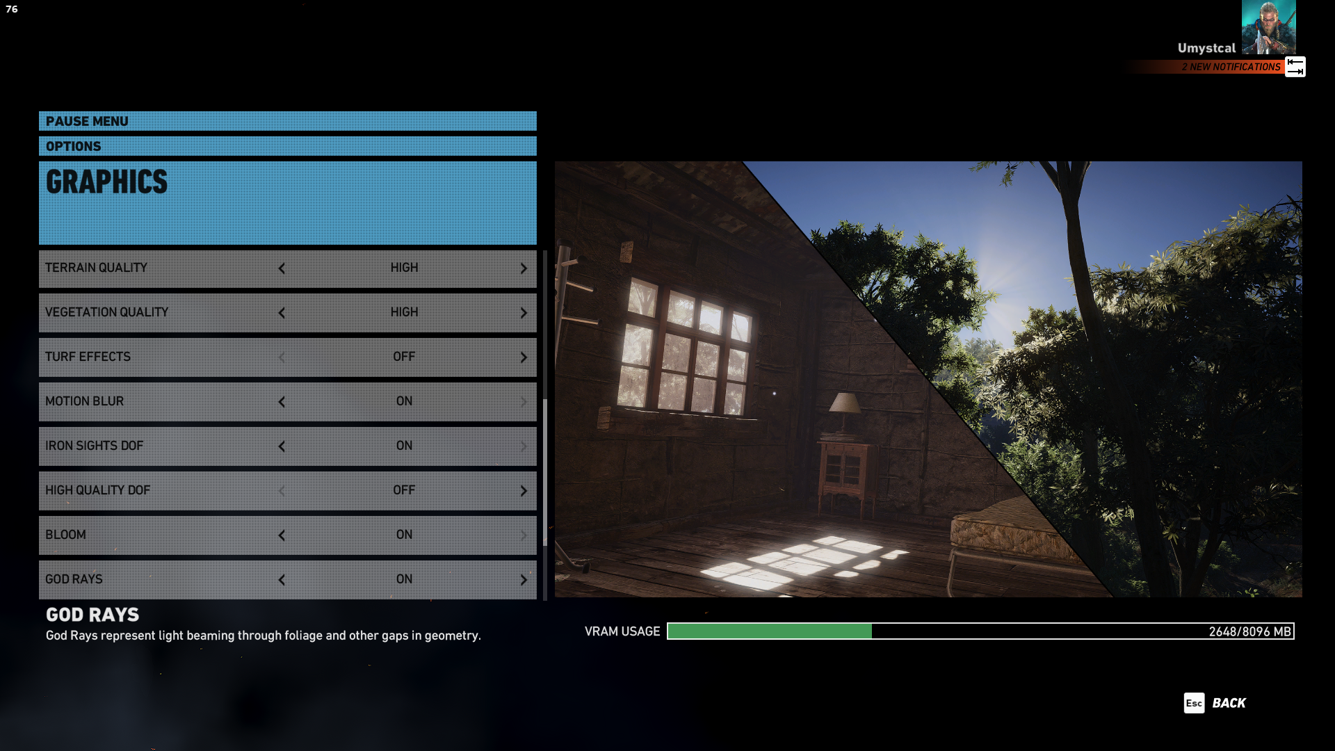

I'm experiencing frame rate drops in Tom Clancy's Ghost Recon Wildlands. I'm using an Intel Arc A750 Limited Edition. I've been having this issue since I purchased the graphics card about 1 years ago, but I'm only reporting it now. I would appreciate a solution if possible. I'll provide a YouTube link showing the frame rate drops in-game, the SSU report, and a screenshot of the game's graphics settings.

* The FPS drops occur when my character enters a crowded area, like a village for example. It stabilizes a bit when I move away from the area and enter a forest.

I have reviewed the Capframex data and it appears that the game is performing well. To assist further, could you share the following answers and proceed with the suggested actions below?
1. What is your expected FPS for this game?
2. Are you comparing your system's performance with other computers or graphics cards? If so, can you share what FPS are you trying to achievi and which graphics card or computer you are using?
3. Additionally, to help troubleshoot the issue, please update your graphics graphics driver to version 32.0.101.6129_101.6045. Before installing the new driver, kindly ensure to perform a clean installation using DDU.
Please check this article on "Low Performance on Ghost Recon Wildlands* with Intel® Arc™ Graphics" for further guidance.

I apologize for the delay in responding. I updated my graphics card driver as suggested, and so far, I haven't encountered any more issues with the game's performance. Thank you for your assistance.
