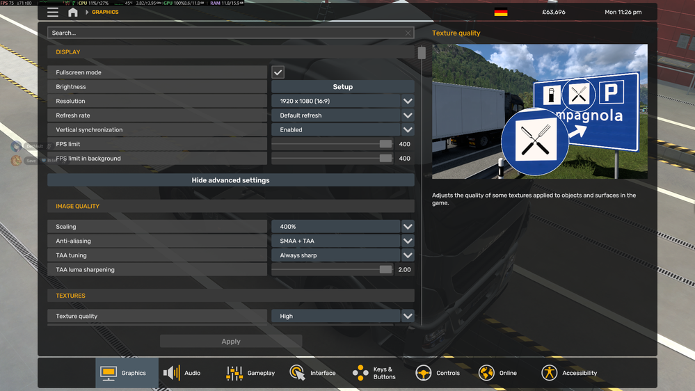

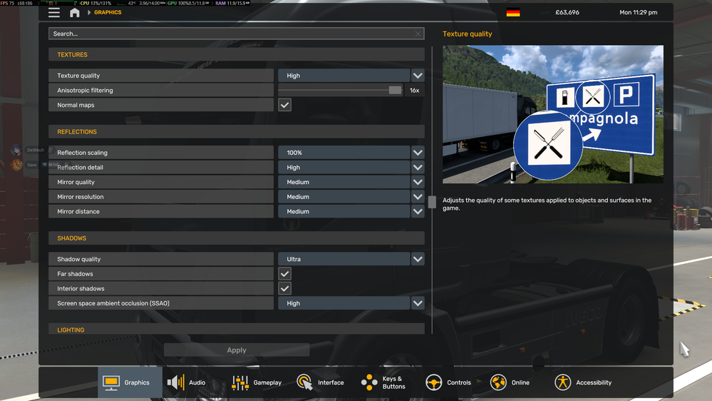

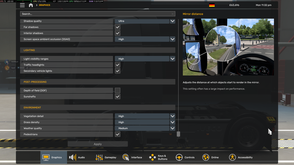

For good measure here's 1 more video of my issue as well as my graphics settings if anyone testing wishes to copy them
(video recorded with the latest Jan 26th drivers installed)
https://www.youtube.com/watch?v=b6L-T48-ldY
Settings:

Thank you for sharing all this information with me. Please be informed that we can only accommodate one game per thread. This allows us to provide more focused and effective troubleshooting.
Kindly let me know which game you would like us to prioritize in this thread, and please share a screenshot of the exact game settings you are using so we can attempt to replicate the issue in our test lab.

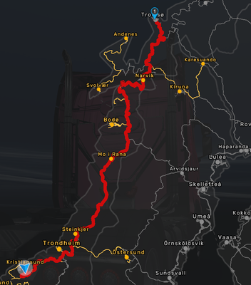

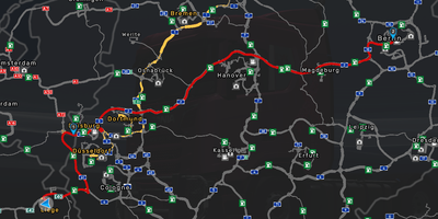

• I recommend playing for at least 3 hours as sometimes, at least with my specific settings I shared above, it can take anywhere from under 10 minutes to 30 minutes before artifacting starts appearing
• When you start your career profile I recommend picking the garage in Liège so you start the tutorial in a truck there, then drive to Berlin by driving past the cities of Duisburg, Düsseldorf and Hanover as lots of objects/buildings render in those cities, which may increase the chance of the artifacting to occur.
Remember to fill up at the closest fuel station on the map first as tutorial trucks will probably start out at low fuel.
-OR-
If you are able to purchase the Nordic Horizons DLC, I recommend picking the Kristiansund garage and driving through Norway up to Tromsø as northern Norway is (probably) the most graphically intensive part of the map in Euro Truck Sim 2.
• You need to keep driving to different areas of the map as it seems new objects, terrain, and buildings loading in is what causes this. As you drive past areas affected by the artifacting, you will see it in your truck mirrors and then will stop temporarily for the next 1 - 10 minutes as you continue driving on.
• It's best to change your FOV to 80 or 90 as well just to make more things render on the screen. You can do this by pressing 4, click on adjust seats, click on FOV and adjust the slider at the bottom of the screen. (same applies to American Truck Sim)

Thank you for providing the exact game settings. I’ll attempt to recreate the issue in our test lab and will provide you with an update as soon as possible.
