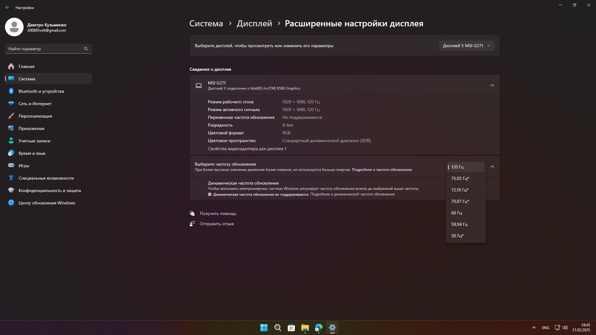

After switching from Gtx 1650 to intel arc b580 I can't make my monitor 144hz only 120hz, I completely reset Windows to 11, tried all HDMI cables and DP also tried but there was only 60hz (the problem was in the cable). My monitor is MSI Optix g271. Write the whole solution, I will try to send all the questions.
Hello, I solved the problem through a custom resolution using the Custom Resolution Utility (CRU). I made it 144Hz, everything works according to the tests. If there are any problems, I'll write again, for now I'm closing the topic.
