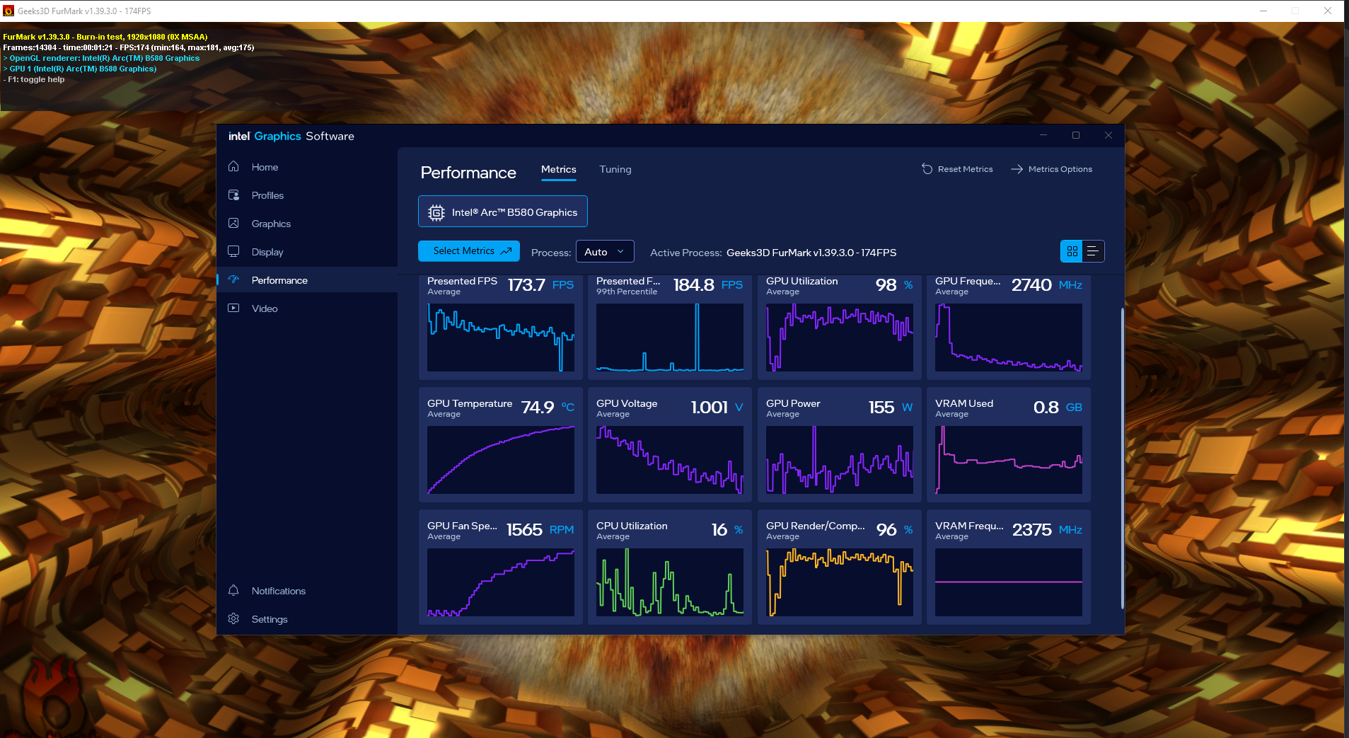

- As I said before, I have no problems with gaming. FurMark works fine. I ran it again with the 3600MHz setting, and everything is normal.
