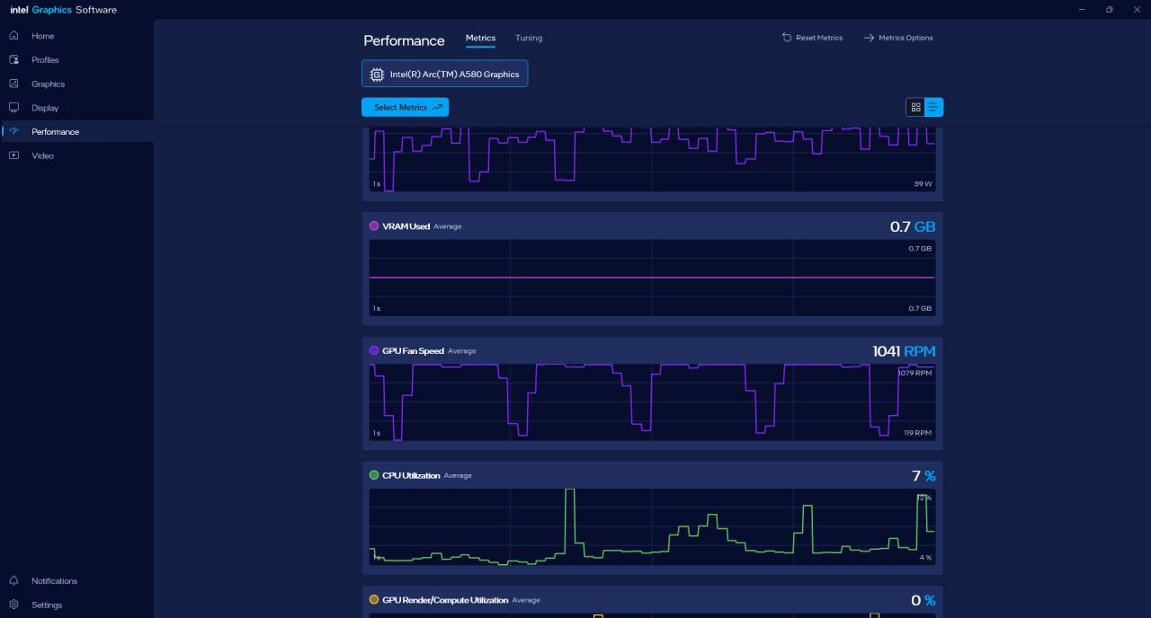

The core issues are as follows:
1. Unstable and Fluctuating Fan RPM at any speed:
When the fan is set to a specific percentage (e.g., 30%), the actual RPM is not stable. It fluctuates wildly by approximately ±200 RPM. This constant hunting for a stable speed creates an inconsistent and irritating audible hum or whine. This is not a smooth operation and indicates poor control logic in the fan curve algorithm.
2. Aggressive and Noisy Fan Start/Stop Cycling :
This is the most disruptive issue. Using the default "Balanced" or similar fan profile:
The fan repeatedly cycles on and off at short intervals (every 5-10 seconds) when the GPU is under light load or idling.
The fan ramps from 0 RPM (0%) to approximately 1050 RPM (30%) almost instantly. This violent, jarring spin-up creates a loud and very audible "whirr" or "surge" noise that is clearly noticeable from inside my computer case. ( Screenshots given below)
This cycle repeats indefinitely, creating a distracting pattern of: Silence... sudden loud WHIRR... 5 seconds of fan noise... sudden stop... Silence... and so on.
Requested Actions:
Release a driver/software update that fundamentally fixes the fan control algorithm. This must eliminate the rapid on/off cycling and smooth ramps
Fine tuning the fan control to reduce rpm fluctuation.
Gpu model : GUNNIR Intel Arc A580 Index 8G

1. No! No third party fan control tool is installed.
2. The issue was from the very beginning. ( This gpu was bought last summer. Back then the ambient temperature was high. the rapid fan start/stop didn't happen because gpu's idle temperature was high. Now in winter this fan start/ stop (default fan settings in intel graphics software) cycle in every 5-10 seconds creates a hum or whine is very audible.
The main cause for this the fan spin time is very fast. Fan rpm accelerates rapidly in fan start/stop cycle. ( A screenshot is given below)
3. No recent changes.
4. My psu is Corsair Rm550x
5. yes, I am providing the SSU logs of my system.
I also providing the fan metric screenshot from intel graphics software.
This issue is not mine only. Here is a post from a different user on the same problems.
Post link- https://community.intel.com/t5/Graphics/SPARKLE-Intel-Arc-unstable-fan-RPM/m-p/1593115#M130489

Yes, I did test the card on a another system. Same issue, fan hum while idling or normal usage.
It appears on system .
1. Windows gpu scheduling is disable .
2. Windows power plan was always in balance mode.
3. Disabled link state power management.
4. Motherboard bios version is the latest one.
5. pci settings is on gen 4.
6. Disabled c state.
7. HWINFO log is provided below.
8. Enabled maximum performance.
9. Dynamic tuning not available.
10. Firmware and Driver updated to the lastest one.
11. reseted gpu many times.
12. Also tested the gpu on a Deepcool PL650D 650WATT psu.
There is no hardware problem. It is happening because of immature fan control algorithm.
here is link to a post from different user- https://community.intel.com/t5/Graphics/SPARKLE-Intel-Arc-unstable-fan-RPM/m-p/1593115#M130489
My card is not overheating . I am just pointing out that on default settings in Fan and thermal tuning the fan accelerates to fast
causing humming noises. I just want, developers to tone down this rapid acceleration. As this creates load on the fan bearings and causes the humming sound.
A screenshot metrics provided below.
