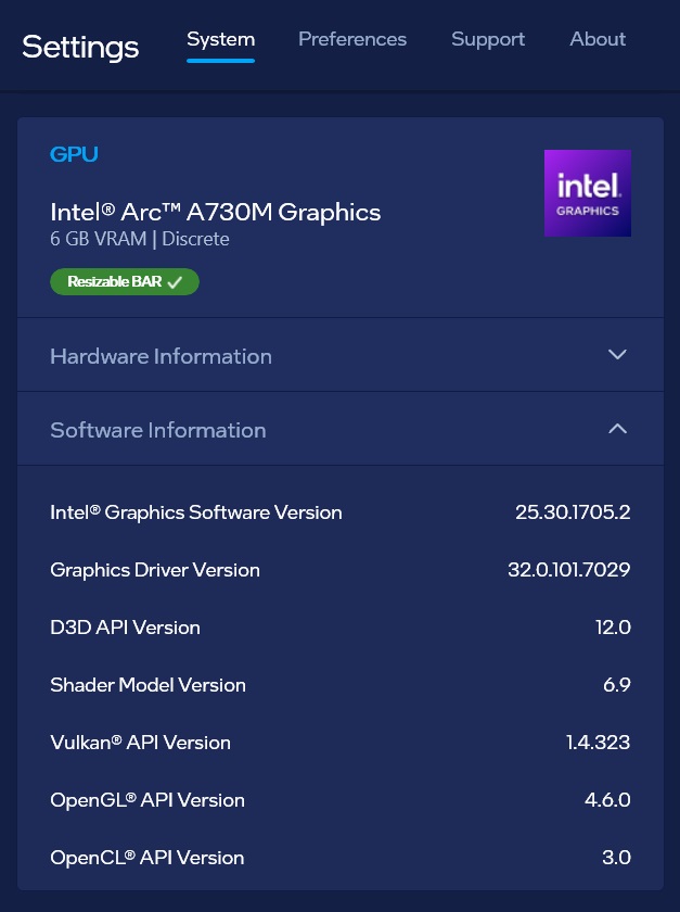

Hi, you assessment is incorrect, unless there is a glitch or bug with the Intel graphics software app.
Because according to the Intel graphics software app, my drivers are up to date, and there are no new drivers available.
There is a separate driver version for both the Intel UHD and the A730m. The Intel UHD has a driver version of 32.0.101.7082
But as you can see from the screenshots (which I took today), the driver for the A730m is still on driver: 32.0.101.7029, because according to the Intel graphics app, there is no new driver for my A730m hardware.
