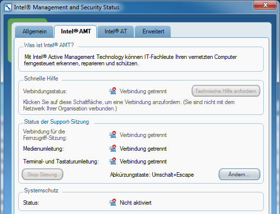

I am using a Lenovo ThinkPad T420 and Windows 7 prof. x64 as my main workstation. Yesterday I did a reinstallation of Windows 7 (ISO image from MSDNAA and not the Lenovo DVD). After the OS and all drivers (using Lenovo System Update) were installed, I had a look at the device manager and recognized the "Intel management engine interface". Since I don't need this function I researched how this device can be disabled. First I had a look in the System BIOS which stated that AMT is disabled:
So I went back to Windows and had a look in the device manger. The device was still there. I decided to use the "Management and Security Status" Tool which stated, that AMT is active ("Aktiviert" in german):
...but that the connections are disconnected ("Verbindung getrennt"):

That particular BIOS setting is particular to the device manufacturer. However, I do not think it activates/de-activates AMT, only whether MEBx can be entered. (A corporation might not want to allow users to enter in MeBX and change settings).  But to be sure, check with the OEM.

It seems, that switching "Intel (R) AMT Control" to "Disabled" in BIOS just resets AMT to defaults. When you switch this option back to "Enabled" and access MEBx, the password is "admin" again, all settings are lost and AMT is active (what seems to be the default setting).
So leaving the BIOS option "Enabled" and disable AMT in MEBx seems to be the only way to deactivate AMT.
