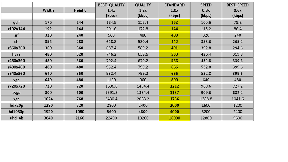

updating to version 3.4.1 has resolved the problem, but the mixed stream bitrate does not meet the maximum set limit of 300 Kbs. It is around 2 Mbps. Why?
Qiujiao_W_Intel
Mitarbeiter
1.526Aufrufe
Hi, david, bitrate option in createRoom API is deprecated in 3.4, if you want to limit bitrate of subscribed stream, please specify qualituLevel option in subscribe API.

Ok thanks for the reply but I would like to understand in more detail the effect of these parameters on a video session of "n" participants with heterogeneous network bandwidth.
I'm developing a web conference application that aims to have 100 participants, so I have to be sure of the network bandwidth that I have to allocate on the server.
many thanks for the kind reply you will give me
David
Qiujiao_W_Intel
Mitarbeiter
1.526Aufrufe
For subscribe actions, bandwidth mainly related to resolution and qualityLevel, here is a reference table for bitrate in different resolution and qualityLevel:
