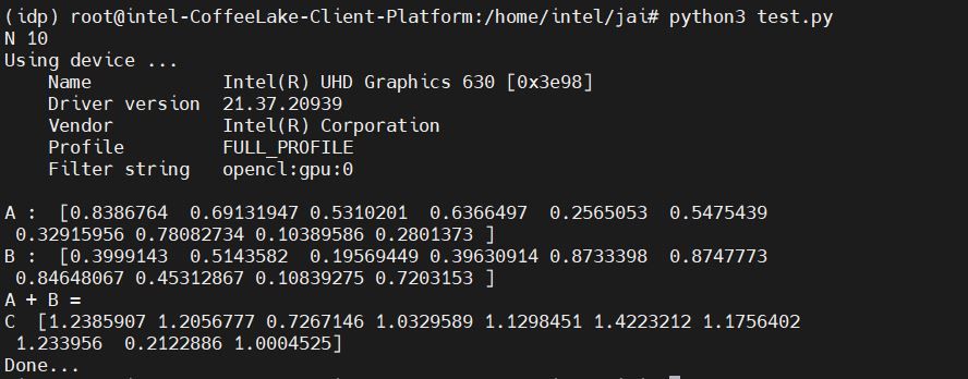

I ran this sample (https://github.com/IntelPython/numba-dppy/blob/main/numba_dppy/examples/sum.py) inside the docker container
That's it. Everything is set and you are good to go:)

We were able to run this sample (https://github.com/IntelPython/numba-dppy/blob/main/numba_dppy/examples/sum.py) with your environment variables and it worked fine.
