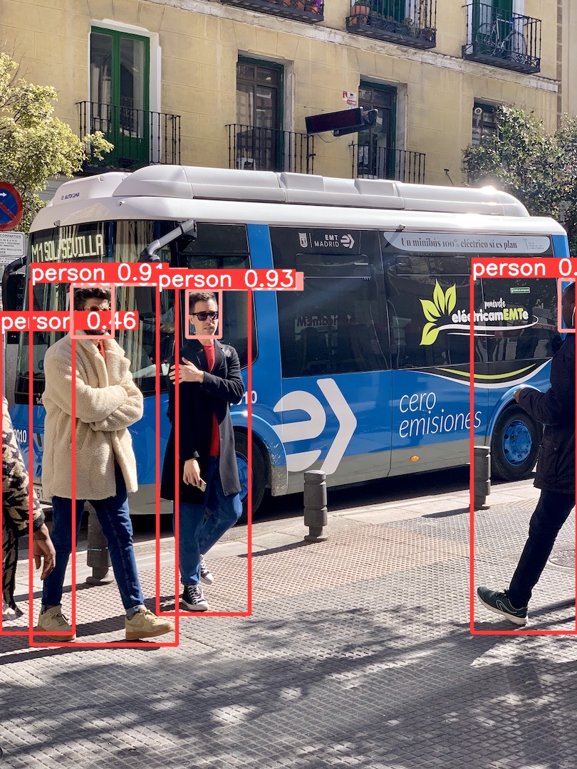

Hi was using yolov5m custom model trained on crowdhuman dataset.
i tried to convert the model IR format using utralytics export.py code and used detect.py there i got the good results.
The same i followed the dlstreamer guide (Yolov5 Model Preparation Example — Intel® Deep Learning Streamer (Intel® DL Streamer) documentation) to convert the model to IR format and used the below model_proc file there i got the multiple and improper bboxes compared to detect.py.
please find the below pipeline and model repo link
Using openvino 2022.3
Model repo: deepakcrk/yolov5-crowdhuman: Head and Person detection using yolov5. Detection from crowd. (github.com)
MODEL_PATH=../models/yolov5_head_openvino_model/FP32/yolov5m.xml
PROC_PATH=../models/yolov5_head_openvino_model/crowdhuman_yolov5.json
cmd="filesrc location=../videos/NVR_ch18.mp4 ! decodebin \
! videoconvert ! video/x-raw, format=BGR \
! queue ! gvadetect model=$MODEL_PATH model-proc=$PROC_PATH threshold=0.7 device=CPU \
! queue ! gvatrack \
! queue ! gvawatermark ! queue ! videoconvert ! fpsdisplaysink sync=false"
gst-launch-1.0 $cmd

Hi Shekarneo,
Referring to Line 14 output_postproc in your Model-proc File, could you please change "labels": ["person", "head"], to "labels": ["head"], in line 23, and see if the issue can be resolved?

Wan_Intel
6,740 Views
Hi Shekarneo,
Thanks for the information.
Could you please change the classes to 1 and see if the issue persists?

Wan_Intel
6,604 Views
Hi Shekarneo,
Thanks for your patience.
I've run your PyTorch model with detect.py from the GitHub repository, and the inference result was good:
https://github.com/deepakcrk/yolov5-crowdhuman/tree/master
Inference Result of PyTorch model with detect.py:
Before converting your PyTorch model into Intermediate Representation, I've converted your PyTorch model into an ONNX model. Are you able to run the ONNX model with your detect.py? I would like to check the inference result of the ONNX model with your detect.py before we convert it into an Intermediate Representation.
Wan

6,518 Views
Hi wan,
I am able to run detect.py using onnx model, Please find the below screen shot
python3 detect.py --weights crowdhuman_yolov5m.onnx --source data/images/bus.jpg --imgsz 640

Wan_Intel
6,315 Views
Hi Shekarneo,
I also encountered an accuracy issue when running the object detection pipeline using YOLOv5m with Intel® Deep Learning Streamer Pipeline Framework Release 2023.0.

Wan_Intel
6,028 Views
Hi Shekarneo,
Thanks for your patience. We've received feedback from relevant team.
Referring to Known Issues in Intel® Deep Learning Streamer Pipeline Framework Release 2023.0, we regret to inform you that intermittent accuracy fails with YOLOv5m and YOLOv5s is a known issue.
Our developers are working on resolving the issue. Please stay tune for the next Intel® Deep Learning Streamer Pipeline Framework Releases. Sorry for the inconvenience and thank you for your support.
Wan

Wan_Intel
5,981 Views
Hi Shekarneo,
Thanks for your information.
We encountered the same issue as you when running the object detection pipeline using your custom YOLOv5m model with Intel® Deep Learning Streamer Pipeline Framework Release 2023.0.
We will fix the issue in the future Intel® Deep Learning Streamer Pipeline Framework Releases. We are not sure when the fix will be available, but please stay tuned for the next release. Hope it helps.
