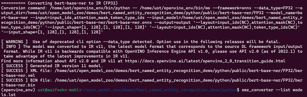

I'm using OpenVINO 2022.3.0 on Ubuntu 20.04.5 LTS (8Gb RAM)
In Bert name entity recognition demo , the mode  was downloaded by using this command
" sudo /home/xactai/openvino_env/bin/omz_downloader --list models.lst "
and also try this command
" sudo python3 /opt/intel/openvino_2022/open_model_zoo/tools/model_tools/downloader.py --list models.lst "
The model was  downloaded successfully.
but model conversion is not done
I'm using this command for model conversion "sudo -E /home/xactai/openvino_env/bin/omz_converter --list models.lst"  and also try this one " python3 /opt/intel/openvino_2022.2.0.7713/open_model_zoo/tools/model_tools/converter.py --list models.lst "
but I got  error like this " /home/xactai/openvino_env/bin/python: can't open file '/opt/intel/openvino_2022.3.0/tools/model_optimizer/mo.py': [Errno 2] No such file or directory
FAILED:
bert-base-ner "
what should I do now ?
Wan_Intel
3,091 Views
Hi Interns_XINTHE,
I've validated the omz_downloader --list models.lst and omz_converter --list models.lst for BERT Named Entity Recognition Python Demo.
Please re-Install OpenVINO™ Development Tools in new virtual environment and see if the issue was able to resolve.
