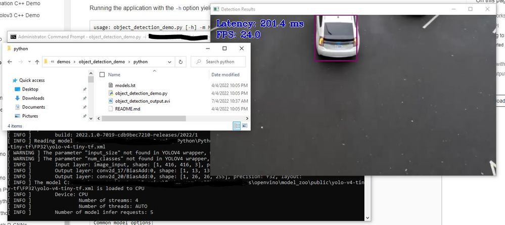

Hi Mostafa,
The error is because you wrongly specify the architecture_type of yolo-v4-tiny-tf model. The architecture_type of the model should be yolov4. You can refer to the Supported Models for the architecture_type of each model. I have verified the demo and the output is as below:
Command used :
object_detection_demo.py -i <path_to_video>\car-detection.mp4" -m "<path_to_model>\yolo-v4-tiny-tf.xml" -at yolo v4 -t 0.5 -o object_detection_output.avi

Hi Mostafa,
Command used :
Aznie
Mostafa-
2,605 Views
thank you, it works now
