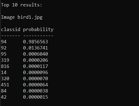

Hi Tithi,
I've validated from my end by building the Image Classification Async C++ Sample and running the sample with Alexnet model. Here is the command for running the sample:
and here's the classification result:
On another note, could you please provide the following information:
  1. Your OpenVINO™ version.
  2. The OpenVINO™ sample that you are running.
  3. Commands used to run your OpenVINO™ sample.
Hairul

Hairul_Intel
2,007 Views
Hi Tithi,
Thank you for sharing your information.
From the image that you've provided, I noticed that you are running the sample in Windows Powershell. I've validated from my end by running the sample in Windows Powershell and there are no output results showing:
Please note that the OpenVINO™ samples needs to be ran in Windows Command Prompt (cmd.exe) to print the results. Here is the classification results from running the sample in Windows Command Prompt:
Refer to the Image Classification Async Python* Sample for more information on running the sample.
