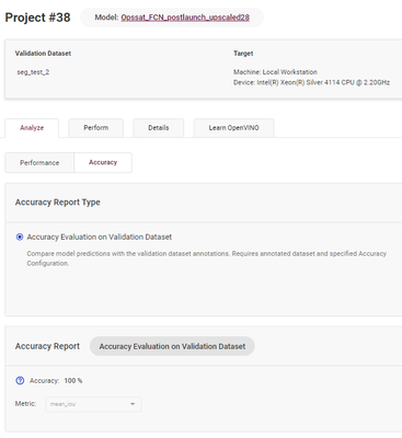

The results of visualization indicates 0-255 classes however this custom NN segmentater is trained on binary class !
The "common semantic" dataset looks right because it is uploading correctly by the workbench (import/upload dataset) including this json file:
"label_map": {"0" : "no-cloud", "1" : "cloud"},
"background_label":"0",
"segmentation_colors":[[0, 0, 0], [255, 255, 255]]
Once the project is created with the relevant custom NN and "vizualise output" is applied on several images then more than 2 classes (from class#0 until class#255) are listed in "model predictions" !
Could you please explain this problem ?

Sorry for delay. We have checked your model. There is indeed a limitation in DL Workbench with visualizing a binary semantic segmentation models. Thank you for reporting this problem.
fredf
11,489 Views
Thank you as suspected it is a limitation of the tool,
so please how I can evaluate the inferences/metrics using OV tool (for instance on the images in the dataset seg_2) cause the function "Accuracy"  provides a strange result (100% not possible on segmentation) but I don't which images are used please? 
Alexander_Suv_Intel
11,438 Views
Accuracy measurement provides such a strange result because accuracy validation was not configured properly. In basic mode 'Configure Accuracy Validation' page can provide settings only for preconfigured default scenarios. There is an option for semantic segmentation but it is a multi class semantic segmentation. As we investigated above your model has limitation in DL Workbench as it is a binary model.
There is however an option to provide a custom accuracy settings for your model in an advanced mode of 'Configure Accuracy Validation' page.
Could you please try to follow next steps:
1. Open 'Configure Accuracy Validation' page. At you project page navigate to 'Perform' -> 'Create Accuracy Report' -> 'Provide accuracy configuration'. After clicking on 'Provide accuracy configuration' you will be redirected to 'Configure Accuracy Validation' page.
2. At 'Configure Accuracy Validation' switch to advanced mode.
3. Configuration should look similar to below. Manually change fields:
 - launchers.adapter.type = segmentation_one_class
- datasets.metrics.use_argmax = false
4. Click 'Save', Click 'Create Accuracy Report'

fredf
11,429 Views
Thanks a lot now the resulting accuracy is no more 100% :
mean_accuracy / semantic_accuracy / frequency_weighted_accuracy = 91.25%
- mean_iou = 46%
No detail on the way are calculated these two metrics but it is quite strange to get so difference between mean IOU and accuracy, do you have an explanation please?
Is this metric report calculated on the full dataset (id est ten thumbnails)? So considering the vizualisation doesn't work on this network how I can please infere (and get the metric) on one image only (except by creating a dataset including only this image)?

Alexander_Suv_Intel
11,328 Views
Metrics computation formulas are described in Fully Convolutional Networks for Semantic Segmentation in chapter 5. OpenVINO Accuracy Checker implementation can be found here.
We found that dataset_meta.json should looks like this as your mask is also binary:
    "segmentation_colors":[[0], [255]]
We also found that 2 of 10 images are in '.jpg' format and that's why your accuracy report was calculated on 8  '.png' images only.
Could you please provide us with the version of DL Workbench you currently using? It seems that the version you using has no support for per image accuracy measurements.
The 2021.4.2 version of DL Workbench introduced a per image level of accuracy report with an ability to visualize a single image:
Regarding the model correctness: as I mentioned the model doesn't seems to work properly, so accuracy measurements and visualization wouldn't provide a valid results. Could you please provide us with the model in ONNX format so we would try to investigate it further?
