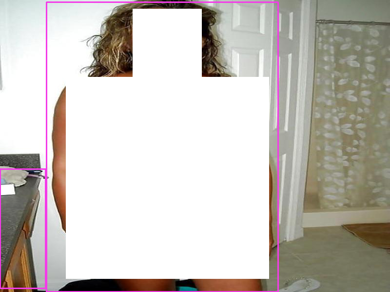

1.Problem:
I want to optimise my custom-trained model (Detects different body parts with faster_rcnn_inception_v2_coco-tensorflow) for my Intel Core i5 which works fine without openvino optimisation. My problem is if I execute my custom-trained model (With my created openvino .xml and .bin files)  with openvino object_detection_sample_ssd.py sample, several irrelevant parts are marked by inference engine, although what I expect is just specific body parts like face, hands etc. (please see attachment for the output:"my output.png").
Could someone please help me about my problem? For the details please see below.
Thanks a lot in advance.
PS:
1-If I execute the same inference engine sample object_detection_sample_ssd.py with pre-trained Openvino model  "faster-rcnn-resnet101-coco-sparse-60-0001", it works totally fine, the person is detected as expected.
2- Originial object_detection_sample_ssd.py file is modified by me(please see attachment for modified file), since the code was crashed during the execution. But the same modified code works fine with faster-rcnn-resnet101-coco-sparse-60-0001 as I mentioned above. Moreover faster-rcnn-resnet101-coco-sparse-60-0001 model got also totally the same errors, during the execution. So it is not possible to execute it with the original object_detection_sample_ssd.py either. Please see the original file in environment link and modified lines in (object_detection_sample_ssd_modified.txt) in attachment. Modified lines are already commented as "#Modified"

2.2.1.Execution:
python3.6 object_detection_sample_ssd_modified.py -i /Users/Documents/Work/Blocker/Tensorflow1/models/research/object_detection/images/test/300_1000.bmp -m /Users/Documents/Work/Blocker/OpenVINO/new/my_frozen_inference_graph.xml --model_bin /Users/Documents/Work/Blocker/OpenVINO/new/my_frozen_inference_graph.bin -d CPU
2.2.2.Execution Output:
[ INFO ] Loading Inference Engine
[ INFO ] Loading network:
[ INFO ] Device info:
        CPU
        MKLDNNPlugin version ......... 2.1
        Build ........... 2021.2.0-1877-176bdf51370-releases/2021/2
inputs number: 2
input shape: [1, 3]
input key: image_info
input shape: [1, 3, 600, 600]
input key: image_tensor
[ INFO ] File was added:
[ INFO ]         /Users/Documents/Work/Blocker/Tensorflow1/models/research/object_detection/images/test/300_1000.bmp
[ WARNING ] Image /Users/Documents/Work/Blocker/Tensorflow1/models/research/object_detection/images/test/300_1000.bmp is resized from (600, 800) to (600, 600)
[ INFO ] Preparing input blobs
[ INFO ] Preparing output blobs
[ INFO ] Loading model to the device
[ INFO ] Creating infer request and starting inference
[ INFO ] Processing output blobs
[0,1] element, prob = 0.975498    (201,23)-(611,562) batch id : 0 WILL BE PRINTED!
[1,1] element, prob = 0.97121    (247,8)-(325,21) batch id : 0 WILL BE PRINTED!
[2,1] element, prob = 0.9709    (23,75)-(246,244) batch id : 0 WILL BE PRINTED!
[3,1] element, prob = 0.958907    (98,101)-(638,498) batch id : 0 WILL BE PRINTED!
[4,1] element, prob = 0.837769    (327,6)-(479,398) batch id : 0 WILL BE PRINTED!
[5,1] element, prob = 0.820504    (459,224)-(631,600) batch id : 0 WILL BE PRINTED!
[6,1] element, prob = 0.804928    (121,13)-(406,577) batch id : 0 WILL BE PRINTED!
[7,1] element, prob = 0.802219    (25,45)-(452,222) batch id : 0 WILL BE PRINTED!
[8,1] element, prob = 0.775234    (386,168)-(448,504) batch id : 0 WILL BE PRINTED!
[9,1] element, prob = 0.435565    (139,11)-(158,29) batch id : 0
[10,1] element, prob = 0.42904    (415,198)-(451,356) batch id : 0
[11,1] element, prob = 0.133711    (452,0)-(787,273) batch id : 0
[12,1] element, prob = 0.112022    (383,275)-(445,600) batch id : 0
[3898,6] element, prob = 3.66124e-05 (2,442)-(52,477) batch id : 0
[3899,6] element, prob = 3.2293e-05 (307,408)-(439,600) batch id : 0
[ INFO ] Image out.bmp created!
[ INFO ] Execution successful
[ INFO ] This sample is an API example, for any performance measurements please use the dedicated benchmark_app tool

emregun
4,360 Views
Hi Aznie,
Thank you for your fast response. The original object_detection_sample_ssd.py did not work either with faster-rcnn-resnet101-coco-sparse-60-0001 model. I did some modifications to make it work. The first 3 errors occur in both models(mine and faster-rcnn-resnet101-coco-sparse-60-0001 model), just the fourth one is specific for mine:
1-Error: "No Error"
1.1Description:The code did not crash but as I know we have to give .bin file also into ie.read_network
1.2Original:
1.3Modification:
2-Error:"Sample supports networks with one input"
2.1Description:Model has 2 input keys:image_info and image_tensor. This problem is also discussed under this topic. https://community.intel.com/t5/Intel-Distribution-of-OpenVINO/Not-able-to-run-inference-on-custom-trained-faster-rcnn/td-p/1156986. But I could not even make object_detection_sample_ssd.py work, as mentioned in topic.
2.2Original:
2.3Modification:
3-Error: ValueError: get_shape was called on a descriptor::Tensor with dynamic shape
3.1Description:Somehow detectionoutput_616 shape value is corrupted. I could achieve to read the value with my modification below.
3.2Original:
3.3Modification:
4-Error: List index out of range.
4.1Description: In my model there are several batch ids(imid). Unfortunately I could not understand what batch id is.  I made a dummy workaround. But I am pretty sure that it is not correct :). I just want to see the end of the execution. (!!!!This error occurs just in my model!!!!)
4.2Original:
4.3Modification:
PS:
1-By the way, there is a wrong detection also in faster-rcnn-resnet101-coco-sparse-60-0001 model as you can see below, but I guess it is training problem. irrelevant from code:
2-You can see my frozen_inference_graph.xml file in attachment if you require. In my case 3.Error occurs for layer id="459".
Thanks a lot for your support.

emregun
4,352 Views
Problem Solved by me:
Following steps work fine with my model and
faster-rcnn-resnet101-coco-sparse-60-0001 model. I guess something is buggy in openvino_2021.2. openvino_2020.4 works fine.
STEPS:
1-install openvino_2020.4 (instead of current version openvino_2021.2)
2-use object_detection_sample_ssd.py in the openvino_2020.4 toolkit(2 modifications were required):
1-original:
not_supported_layers = [l for l in net.layers.keys() if l not in supported_layers]
modification:
not_supported_layers = [l for l in net.input_info if l not in supported_layers]
2-original:
net.layers[output_key].type
modification:
for output_key in net.outputs:
if output_key == "detection_output":
3-regenerate my xml and bin in the openvino_2020.4 toolkit :
sudo python3.6 mo_tf.py --input_model /Users/Documents/Work/Blocker/OpenVINO/frozen_inference_graph.pb --transformations_config /opt/intel/openvino_2021.2.185/deployment_tools/model_optimizer/extensions/front/tf/faster_rcnn_support.json --tensorflow_object_detection_api_pipeline_config /Users/Documents/Work/Blocker/OpenVINO/pipeline.config
4-Execution with new xml created above:
python3.6 -i /Users/karoantonemre/Documents/Work/Blocker/Tensorflow1/models/research/object_detection/images/test/072_1000.bmp -m /Users/karoantonemre/Documents/Work/Blocker/OpenVINO/new/frozen_inference_graph.xml
