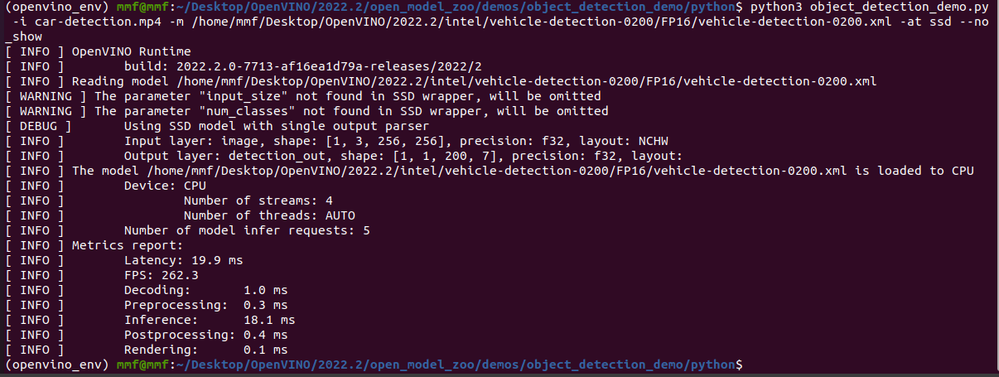

Hi Aqil-ITXOTIC,
I have validated on my end Object Detection Python Demo with vehicle-detection-0200 model using the car-detection.mp4 video from the sample videos page. I ran the demo on both Ubuntu 20.04 and Ubuntu 22.10 using Intel® Core™ i7-11700K.
I also configured the number of streams "-nstreams" to auto, automatically set to 4 and manually to 10. I share my results below:
Ubuntu 20:
Ubuntu 20 "-nstreams 10":
Ubuntu 22:
Ubuntu 22 "-nstreams 10":
For your information, vehicle-detection-0200 model is based on the MobileNetV2 backbone. From our Benchmark Results, the ssd_mobilenet_v2_coco_tf model was validated on Intel® Xeon® Gold 5218T CPU and got 412 FPS for FP32 precision. Do note that the CPU configuration uses Ubuntu 20.04.3 LTS and Kernel 5.4.0-42-generic. You can find more information on the configuration details from Benchmark Setup Information.
