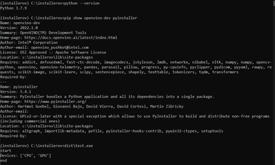

For your information, I've successfully created the executable file using Python 3.7.9 together with the following packages version:
On another note, referring to this thread which discusses issues regarding PyInstaller, here are some of my suggestions for you to try out:
  1. Use --add-data command instead of --add-binary
  2. Give the following directory "C:\<openvino_env_dir>\Lib\site-packages\openvino\libs\plugins.xml;." for --add-binary or --add-data command.
  3. Use the same Python and its packages version as mine (Python 3.7.9, OpenVINO™ 2022.1, PyInstaller 5.4.1).

Hairul_Intel
7,363 Views
Hi Anjaneya Srujit,
I've attached below the Python code file that I used when building the executable file.
Hairul
