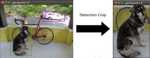

GstInference is a  GStreamer plugin that enables out-of-the-box integration of deep learning models with GStreamer pipelines for inference tasks. This project is open source, multi platform and now it supports OpenVINO through the ONNX Runtime inference engine. Support for Intel® CPUs, Intel® Integrated Graphics and Intel® MovidiusTM USB sticks is now available.
Check out code samples, documentation and benchmarks for GstInference here.
Detection crop exampleDetection crop example
