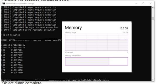

This always happens when using ov::Core in the C++ execution environment.
I checked with OpenVINO2023.0.0 C++ sample (classification_sample_async) using the _Crt Mem method.
And it was the same with the previous version (2021.4.752 or 2022.3.0).
I attached the code for memory leak confirmation that added _CrtMem to the classification_sample_async sample (main.cpp)
Running this detected the leak as below:
Dumping objects ->
{253771} normal block at 0x000001BAE43B8700, 112 bytes long.
Data: <@ ; 0 ; > 40 8F 3B E4 BA 01 00 00 30 98 3B E4 BA 01 00 00
{253770} normal block at 0x000001BAE43B9830, 112 bytes long.
Data: < ; @ ; > 00 87 3B E4 BA 01 00 00 40 8F 3B E4 BA 01 00 00
{253769} normal block at 0x000001BAE31B4590, 128 bytes long.
Data: <@ ; @ ; > 40 8F 3B E4 BA 01 00 00 40 8F 3B E4 BA 01 00 00
{253768} normal block at 0x000001BAE3218760, 16 bytes long.
Data: < v > 00 76 80 08 F8 7F 00 00 00 00 00 00 00 00 00 00
{253767} normal block at 0x000001BAE43B8F40, 112 bytes long.
Data: <0 ; ; > 30 98 3B E4 BA 01 00 00 00 87 3B E4 BA 01 00 00
{253766} normal block at 0x000001BAE32173B0, 16 bytes long.
Data: < u > E8 75 80 08 F8 7F 00 00 00 00 00 00 00 00 00 00
Object dump complete.
Any plans to fix this?
Thank you!

Hi North-man,
We have validated your main.cpp and we are unable to observe any significant memory leak compared to the default main.cpp.
Could you share how you test the memory leak so that we can duplicate it on our end?
Aznie
Hi Aznie,
Thank you for your response.
Sorry, I didn't explain enough.
I'm running in Debug mode in VisualStudio 2019.
If there is a memory release leak in the heap area immediately after executing the _CrtMemDumpAllObjectsSince method, it will dump the information.
Please let me know if any information is missing.
North-man

Hi North-man,
We have received updates from our development team as follows.
`CrtDumpMemoryLeaks()` reports all objects that weren't destroyed (global objects too). So, they were able to reproduce the issue with `include "openvino/openvino.hpp"` only (without any execution in main), or with `DEFINE...` macro from `gflags` library (used by sample) without OpenVINO at all. According to analysis above, such report can't be treated as a real product memory leak. They suggest using `sanitizers` or `valgrind` tools as more reliable tools to check the memory leakage.
More details about how we are tracking memory leaks may be found in the link below:
Peh
Hi Peh,
Thank you for your report.
Surely it happens just by defining gflags like below.
gflags::ParseCommandLineNonHelpFlags(&argc, &argv, true);
Ok, I'll try using 'address-sanitizer' or 'valgrind' to check.
I will contact you again if there are any points that I am not satisfied with.
Thank you.
North-man
