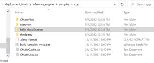

I tried to create my own project based on OpenVINO samples and I managed to do so without issues.
These are the steps:
1. Install OpenVINO and its pre-requisites
2. Run setupvars.bat and try to run a readily available sample to ensure it really works
3. Create a backup folder for the original sample
4. Delete all other sample files except these:
5. If you change the sample application name, the CMakeLists.txt needs to be changed too. (For my case, I didn't)
6. Build the sample
7. Open the generated binaries (Samples.sln) from the Document location ( .../Documents/Intel/OpenVINO/inference_engine_cpp_samples_build)
Only 1 sample is available now as expected
8. Set the project as startup project
From this point onward, you can start customizing the code accordingly, and bear in mind that any error that comes up from here is related to your changes (not the official OpenVINO issues). Hence, you’ll need to debug & fix the error.
This is the easiest way because it already has the required path/dll linked where you don't have to manually set them.
You'll need to run the setupvars.bat before inferencing or etc.
(optional) You can Create a batch file to initialize OpenVINO™ environment and launch Integrated Development Environment (IDE), (eg: VS2019):
@Echo on
cd \bin
CALL setupvars.bat
cd \2019\Community\Common7\IDE
CALL devenv.exe
Run the .bat file as administrator
Previously, some issues come up when msvc 2017 is used instead of 2019. It would be best if you could use 2019 version.
