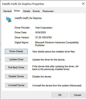

I tried updating my driver to the recommended version and switching to the latest version of openvino. This did not solve the issue.

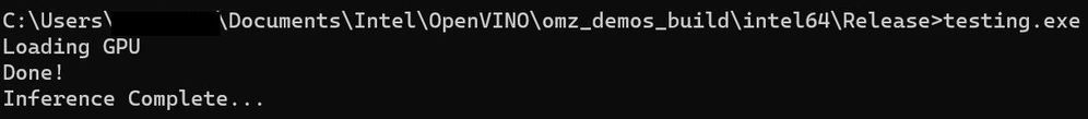

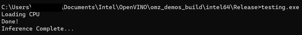

For your information, we can compile and run the application with yolo-v4-tf model successfully when using the CPU and the GPU plugin.
Load CPU Plugin:
Load GPU Plugin:
