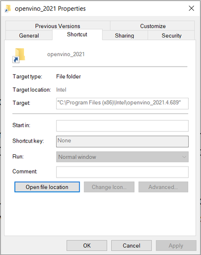

Hi, again.
I am also testing Distribution of OpenVINO™ toolkit for Windows 10.
I installed and registering setupvars.sh for cmd.exe,
Installation directories are two.
And the contents of 'setupvars.sh' are same.
Which is the correct location for after?
No problem?
Thanks, again.
Hairul_Intel
1,064 Views
Hi gb8,
For your information, the openvino_2021 is just a shortcut folder corresponding to the OpenVINO Toolkit version that you installed.
You can confirm the version of openvino_2021 shortcut folder by going to the properties and see the target ("C:\Program Files (x86)\Intel\openvino_2021.4.752") as shown below:
From my end, the openvino_2021 shortcut folder is just directing to the openvino_2021.4.752 folder. Thus, my setupvars.bat in openvino_2021 shortcut folder is actually from the openvino_2021.4.752 folder.

Hairul_Intel
1,037 Views
Hi gb8,
The openvino_2021 shortcut target will change to the version of the latest installation that you've performed if it is in the same release year.
For example, my current version is openvino_2021.4.752. However, when I install another previous release version of openvino_2021.4.689, the openvino_2021 shortcut target is changed automatically as shown below:
It is recommended that if you have multiple installation versions of OpenVINO, you need to provide the full path for the particular version you want to use instead of using the openvino_2021 shortcut.
