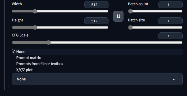

I installed stable diffusion and openvino as follows. Everything is fine but when I run it, in the script dropdown there is no option Accelerate with OpenVINO.

Could you please follow the steps below and see if the issue can be resolved?
- Add huggingface_hub==0.20.2 to requirements_versions.txt
- Activate your venv (On windows it's venv\Scripts\activate)
- Run pip install -r requirements_versions.txt
- Run webui-user.bat
