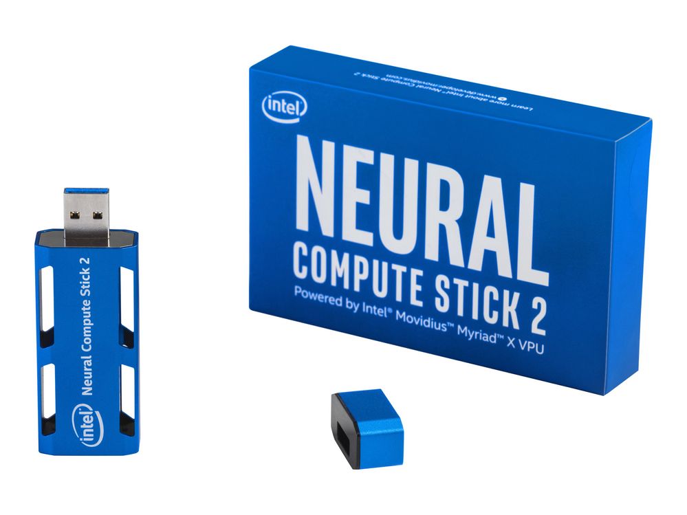

Intel® Neural Compute Stick 2 will run on Ubuntu 20.04 LTS but it is not validated to run on Ubuntu Server.
For purchasing, Intel® is discontinuing the Intel® Neural Compute Stick 2 (Intel® NCS2) with the Last Product Discontinuance Shipment Date on 30 June 2022. You can read more about the Discontinuation Notice here. We apologize for the inconvenience.
For your information, the product you mentioned is not the Intel® Neural Compute Stick 2. I share the Intel® Neural Compute Stick 2 image below.
On the other hand, you can refer to the Intel® Distribution of OpenVINO™ Toolkit System Requirements to check out other Intel® hardware that is supported for OpenVINO™.
