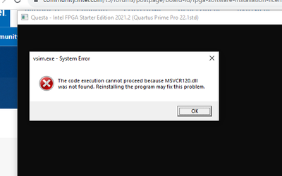

I know this has been discussed earlier. I followed all previous discussions on the community. Nothing helped.
When I launch Questa, it gives me the following error:
I installed the following Quartus :
I can launch Quartus.
I generated a fixed License. I can send you the license through private chat or email.
I installed the Microsoft Visual C++ Redistributable for Microsoft Visual Studio 2017. I set the LM_LICENSE_FILE variable value. I also followed the following threads:
This
This
But nothing seems to be working. I have also re-installed the whole software multiple times. Nothing is working.
Any suggestions for me?

So the problem got solved once I installed Microsoft Visual C++ Redistributable for Microsoft Visual Studio 2013
https://www.microsoft.com/en-us/download/details.aspx?id=40784

For your information, it's worth noting that Questa Intel FPGA Edition versions prior to 22.4 did not automatically install the Visual C++ Redistributable Packages for Visual Studio 2013. This was the cause of the 'MSVCR120.dll was not found' error message in the past.
https://www.intel.com/content/www/us/en/docs/programmable/683472/22-4/software-requirements-24995.html
