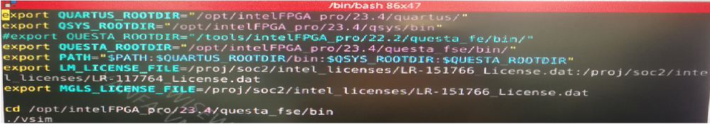

I'm having a valid license for the Quartus 23.4 from FAE. I could open the quartus software GUI successfully but could not open the QuestaSim.Are there any configuration errors with my environment variable ?The environment parameter configuration as follow(set_env_param_1.sh):
The license file as:
When I source the env file,it report error as:
if I enter qpro command, the quartus GUI would be opened with no license question.Why Questasim could not?

Welcome to Intel forum. Could you help re-confirm your environment variable setup again? But before setting up Questa, would you kindly help check, whether your machine is supported or not (OS) by referring to link below:
https://www.altera.com/support/support-resources/download/os-support.html
You need to set your LM_LICENSE_FILE environment variable to point to the license that Intel provides. c:\intel\license.dat or something similar.
You can refer to link on how to set environment variable.
To make this entry, you may perform a windows Search for "System Variables" and then click on "Edit the System Environment Variables" and then click "Environment Variables". Be aware that you must add the entry in System variables, not user variables.
https://www.intel.com/content/www/us/en/docs/programmable/683472/21-4/environment-variables.html
Thans for your help.I re-applied a new license file for Questa, the expiration date was a year.Now,The problem is solved and it works well.
